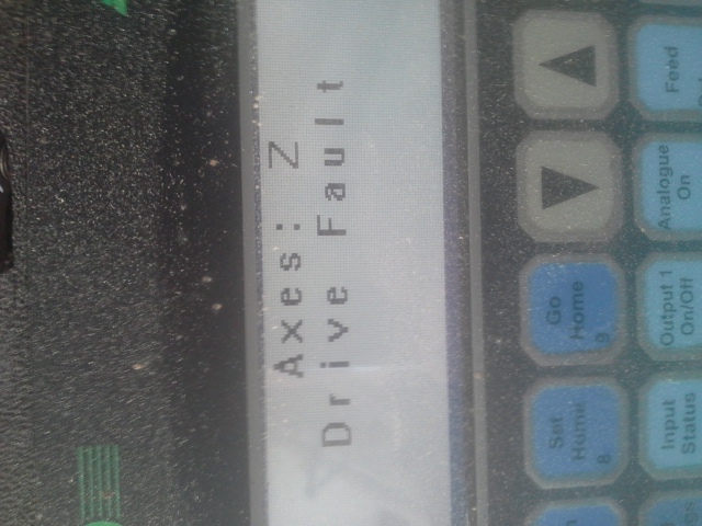

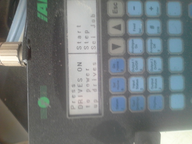

We have been working on troubleshooting an issue for a few months now on a Panel Pro 145G12, not powering UP Z axis prior to Datum. We know this because when we power on the CNC, it doesn't go to "Ready for Datum" once everything is pressed on. When pressing "Datum" it goes immediately to "Z drive failure"

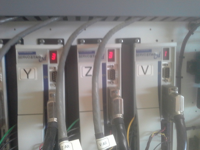

Also we know that we should be seeing ALL "3." on the motors. We are getting all "3" without the decimal point.
