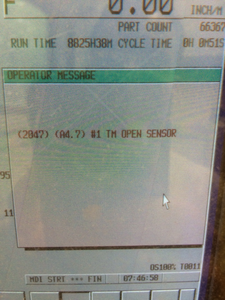

I have an Anderson SUP/Stratos with what appears to be a tool magazine/carousel problem. I think the problem is that there is some debris caught in the mechanism that rotates the carousel but im not sure. I'll attach a picture of the alarm displayed. The alarm says (2047) (A4.7) #1 TM OPEN SENSOR. Any help is greatly appreciated!

Check the book to see what that alarm actually is.
Could be that the carousel didn't return all the way to the home position. Try pushing the manual jog button for the carousel. If it moves, not the carousel problem. If you can move the carousel manually, that is your problem.
Other thing is if there was no tool where you said there was one, it thinks it's supposed to have a tool in the spindle.
