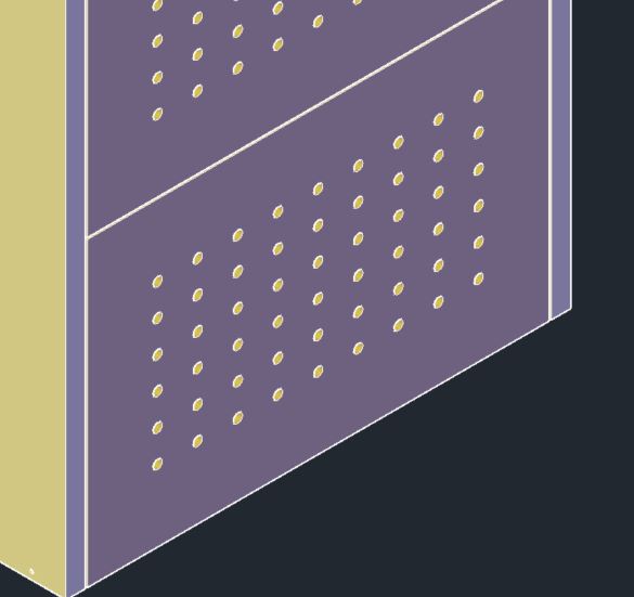

Does anyone have any suggestions on the best type of router bit for this application?
These are holes that are approx. 9/16" diameter, and I tried running them with a 1/2" downcut spiral. Not a good idea! Chips are being pushed to the bottom of the holes and creating a lot of heat.
I thought I might try a compression spiral, but I'm concerned with it pulling up veneer on the face. Also thought about using 1/4" diameter bit??

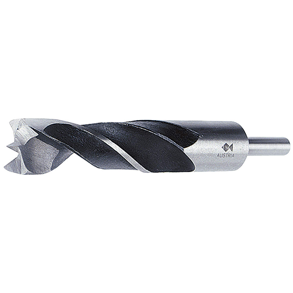

Have you considered "Brad point" drill?
I try to use them when I need flat bottom holes. Its a lot faster and less machine wear than circular interpolating a bunch of holes. Good luck

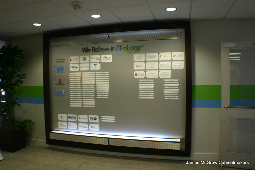

I did a perforated detail with Aluminum Laminate , ( I presume you are doing this on a cnc) Mine was done on sintra and had heat and compaction as well.
I ran a first pass with a .25 DS bit partially into material. then switched to a .25 US bit for the cut thru, time consuming yes but the work looked great !
