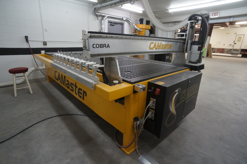

I have two CAMaster Cobras, a 508 and a 510. I have had no limitations of any kind from panel production to custom carving. I agree if you are gona do a lot of thicker hardwood work then the 7.5 or 10 HP spindle may be a blessing. My 5hp HSD ATC on the 508 is now 4 years old and has seen some heavy use and shows no sign of being any where near a rebuild. I have owned six CAMasters as I stepped up to the machines I have Now...
I am also totally sold on the wincnc controller, WINcnc has just announced a wireless hand held with dial control for close up work. this is an asset in carved detail work. All of the machines you mentioned have strong merit yet I have had no trouble or limitations of any kind with Mine.
as always I encourage visiting shops with machines. feel free to call My Number is on the Website...
Having had a Shopbot you know the value of Strong Peer to Peer support so the Forum camheads.org is another total plus. there are dozens of Owners of CAMasters there who moved from the Blue machines to the CAMaster so there are those ahead of you if help is needed. The SB machines are a great platform you will have No trouble stepping Up.

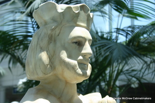

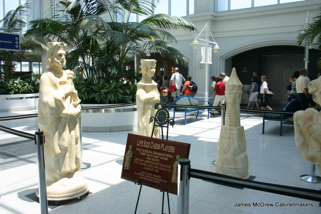

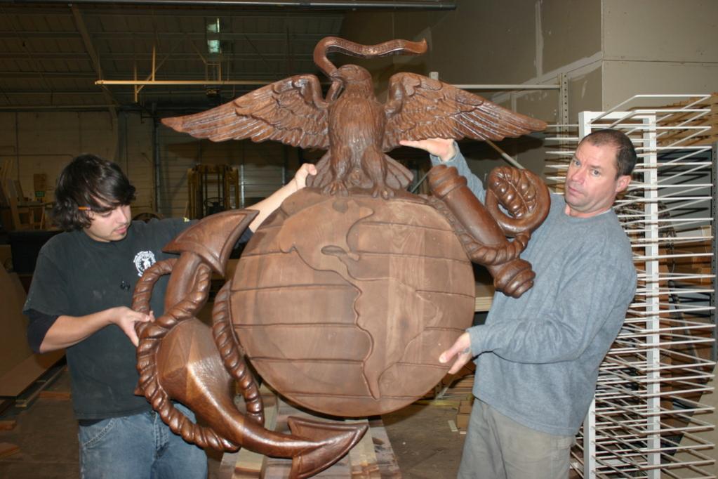

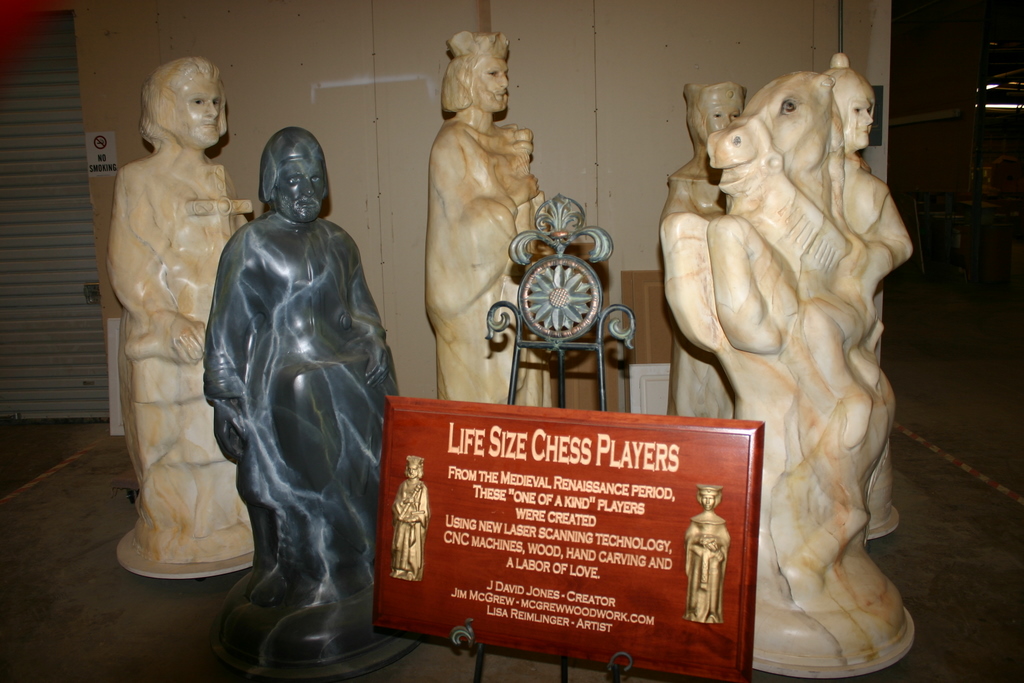

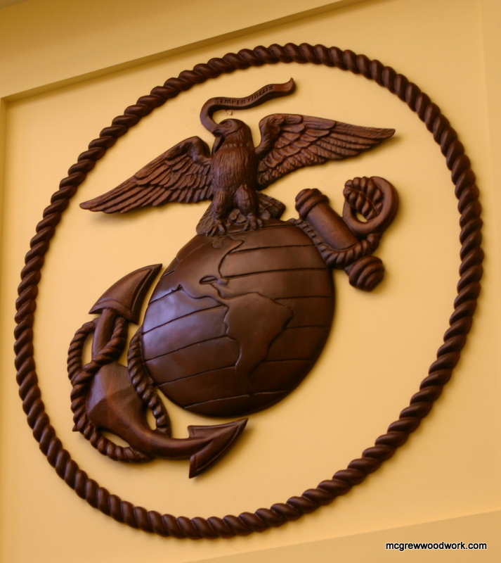

BIG CARVINGS !! I have had some fun with this, I looked at your Site ,, We have a lot in common

Those life size carvings are amazing, James! What sort of material are they made from?
Brian, thank you for the info on the Patriot machine. It is definitely one near the top of our list so far and we are hoping to meet with them for a demo soon!
9/21/15       #11: Advice for custom shops new CNC pur ...
james mcgrew
They are layers of 1" Glued into layers of 3" each Mdf carved slices of a full Life size stl Model.
