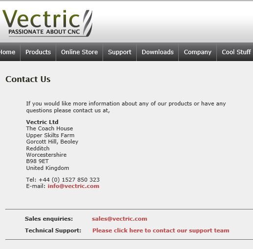

I have a 2006 SCM Routech Record 125 with the Xilog plus software. I recently bought the Aspire software and am unable to run anything. Anyone out there have the same problem, or know of a solution? I have tried all the post processors that are in the drop down menu that have to do with SCM or Morbidelli and have no luck. I have emailed the tech support folks at Aspire, and have yet to receive a reply (3 days and 2 emails). I have also registered to their forum, but have yet to get my account approved (3 days and running).....somebody please help!

You do need to get to the Forum, there are discussions on the SCM, Xilog etc. I do not have one so I do not know what I am reading. as well on the PP section at the bottom of the forum there is a guide for editing,, Vectric is probably the only company that goes as far as it does (hundreds of pp) with helping on this.
if you do not get a response I will send an email to some I know at the company.

Thank you for the responses, Jerry I checked my spam folder, no luck. James, I did research the Aspire software, and one of the things people seemed to talk about was the good support, so I am a little, well more than a little, disappointed I have yet to receive any response from them. The time difference may have something to do with it, I am in Hawaii, 12 hours behind Europe, but it has been 4 days now, so that shouldn't really be an issue. I am excited to use the software, but am frustrated I have paid the money, and I can't get it to work. If you can do anything to help speed up the process, I would greatly appreciate it. Aloha

Just received a response from Vectric, hopefully we can get this worked out.
