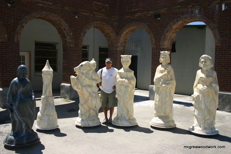

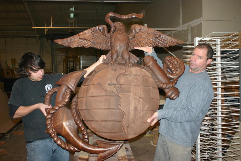

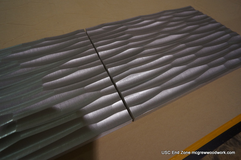

Camaster is wincnc controlled. feel free to ask about what you want to achieve, go visit shops, we hold a really big CNC event in my shop in April that draws camheads, botters and a host of talented fellows in this stuff when it comes to custom
just what do you want to do and the chess players were done with a single head machine with a 6" z clearance

Incredible work by the way. I can see how most of those items were done on a CNC but those giant chess players are a whole new level. Fantastic results!
