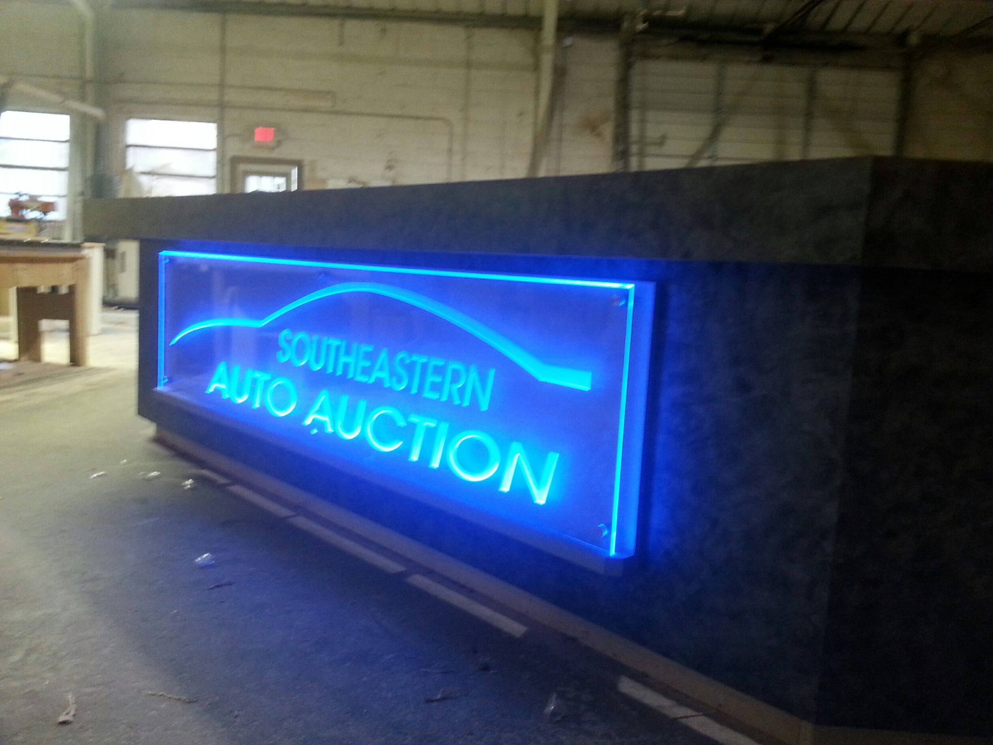

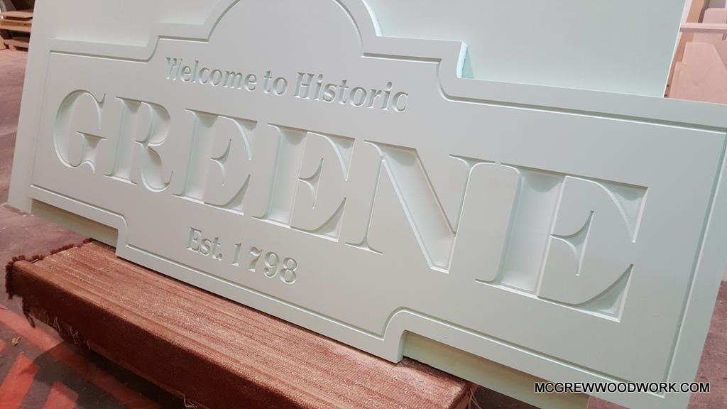

Aspire will be the best learning curve with excellent results. I use it daily for everything from radius reception desk to hdu signage.
Key is try it before you buy it,, you will get help on their forum
