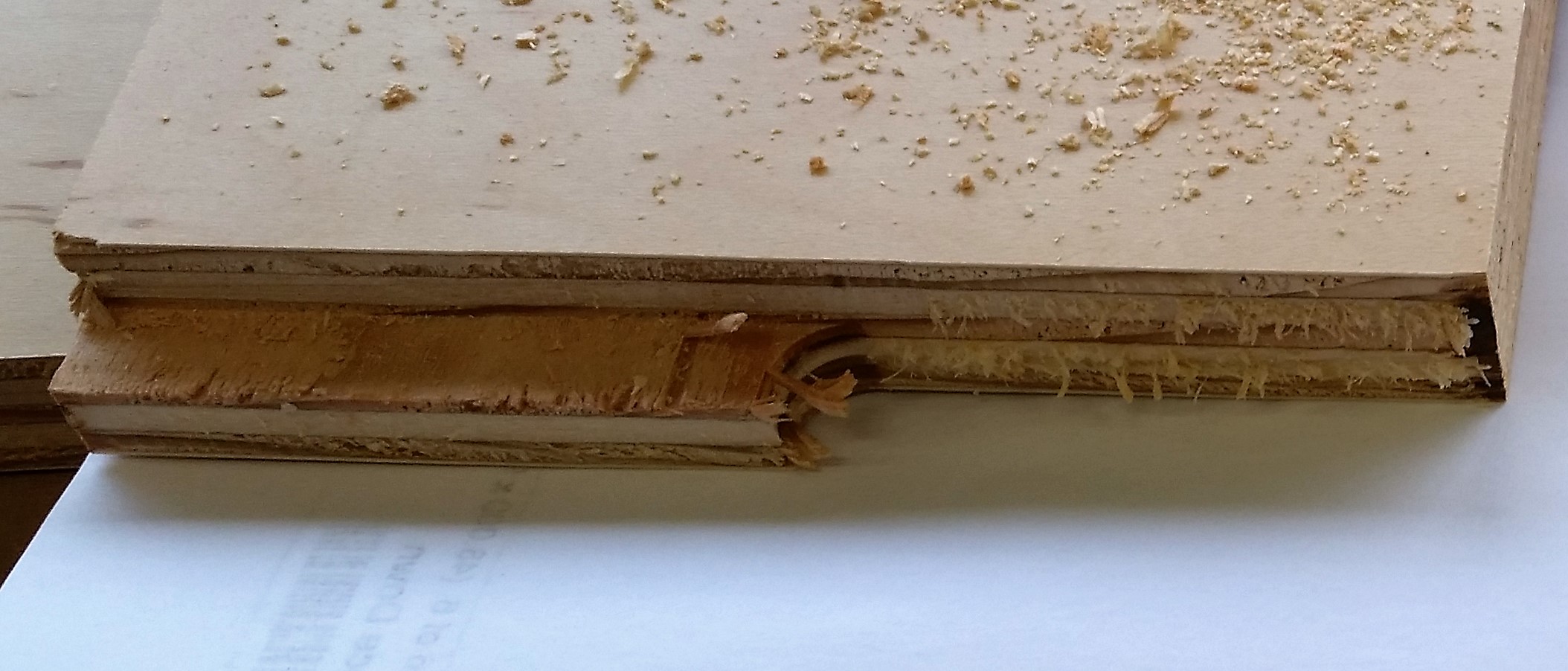

We are just getting started running jobs with our Pratix. Here is a photo of the edge quality in pre-finished maple. You may not be able to see in the photo, but the the edge is not straight, there is a slight step. Terrible! Test pieces run in melamine were near perfect. Speed, feed rate, tooling? Any input as to what we need to change would be appreciated.

What are you using for tooling ?
A 3/8" compression but should deliver great results , much cleaner than your picture . Feeding @ 450 IPM (a lot of production guys run faster ) @18,000 rpm
Even a 3 flute down cut should yeild better results

we started running at a much higher spped to reduce tooling wear. It was such an increase that parts were moving and I have a 40hp pump Then we started return onion skinning everything. Edge is much better and the parts are coming off done and clean

daveguru
Make sure you "Power Cut" plywood as opposed to "Climb Cut".
Climb cutting will give you the furry edge finish in the pic.......

jerry Member
It does look like he is climb cutting. I would do some tests cuts but cut the pieces so you have a drop and look at both sides of the cut and see what side is better. then change direction and cut again

If the edge needs to be decent I use chipbreaker compression spirals and if not I use roughing bits.
2 flute compression spiral chipbreaker - 600IPM climb cut full depth less 0.030, finish pass 600 IPM full depth opposite direction, slower finish pass smaller pieces.

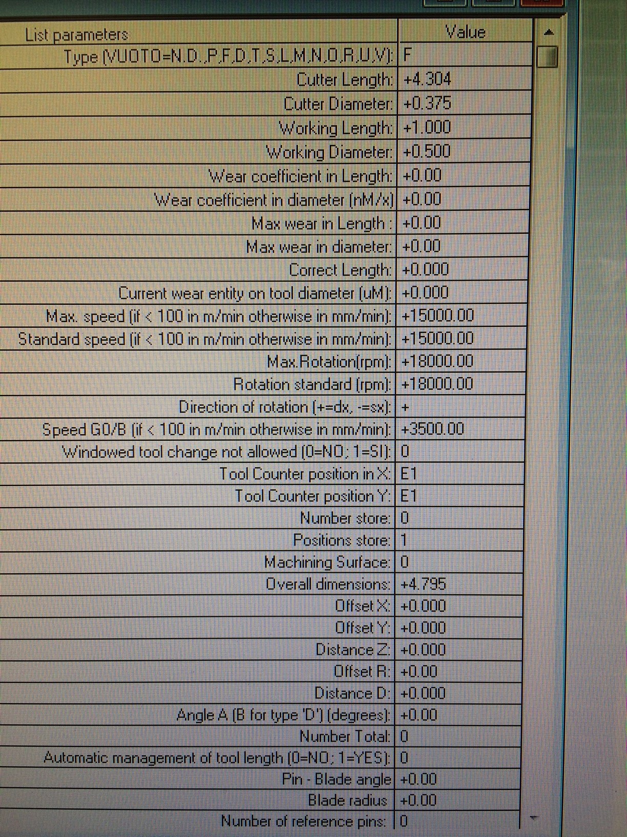

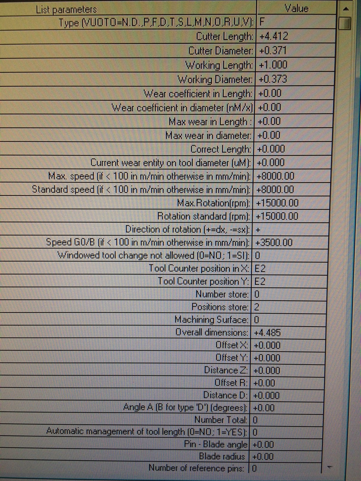

That's pretty bad. We have the same router. We use an Onsrud 3/8" Compression bit with marathon coating for our outlines and a Vortex 3/8" Down for dados. I'll post a pic of the tool settings for both. The software should look familiar. The one with the cutter diameter of .371 is the down and the one with the cutter diameter of .375 is the compression.

Am I the only one who noticed the scorched edges at the corner and the beginning of the tenon? Make sure that you are cutting a round toolpath around your corner. I have been cutting baltic birch 1/2" thick at 22-23 Meters/minute (about 900 ipm) with an onsrude 3 flute mortise compression. Nearly perfect edges but we had to change our onion skin to 0.07 thick or it chipped really bad on the bottom edge. We run 3/4 melamine 28-30 M/Min on melamine depending on the parts.
