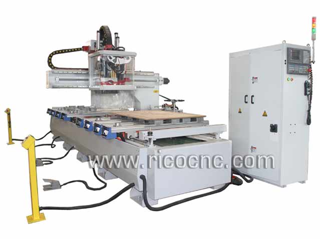

yes, you can work with veneered sheets of melamine chipboard for the customers.
Adjust the vacuum bars and suction cups position for whole wood sheet, if need cutting, had better use a spoil board under your sheet.
