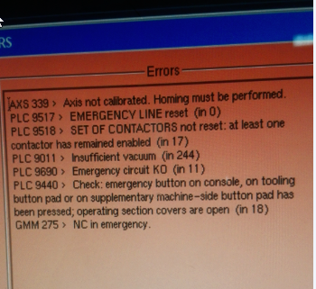

Biesse Rover A3 machine error message
PLC 9440 Emergency alarm is coming

I'm sorry if this is a dumb suggestion I have a biesse skill
Did you check that the trip wire isn't triggered?

its one of the mushroom buttons..as always..704-357-3131 for biesse service if you need additional troubleshooting

yaakov
99% its not the mushroom,
mushroom had is plc indicator(input signal) and you got an alarm about that
it seems more like one of the NC contacts in the second emergency line

yes , you are correct. can you tell me which one is secondary emergency line

Jason Scott
I get that message anytime I haven't pushed the white button and energized the system. It's on the screen after a couple of minutes after any stop or the black button has been pushed.
