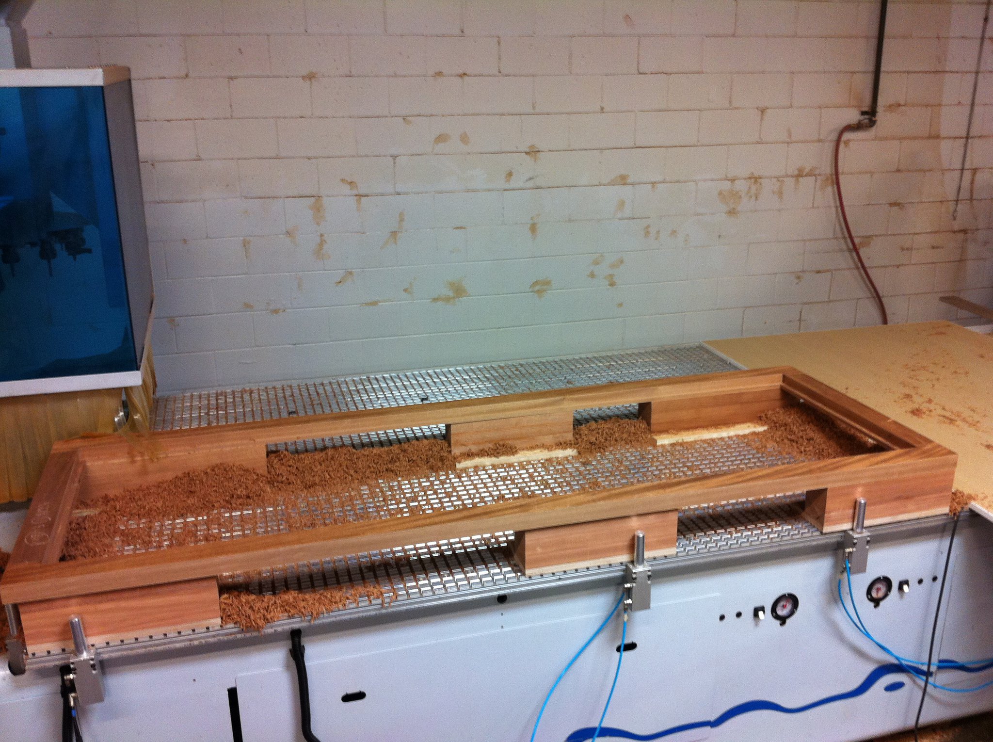

Get a nesting machine with suction cups that fit into the nesting table. I setup a wine cellar business for an associate and i bought a Homag nesting machine with 4-axis(aggregate capability). They nest cabinets 80% of the time, sometimes they use pods i made for them(you can buy ready made pods as well) that elevated the work 100mm and do entry door locks and hindges machining with horizontal aggregates. You need to have a decent enough clearance in Z-axis and a stroke large enough.

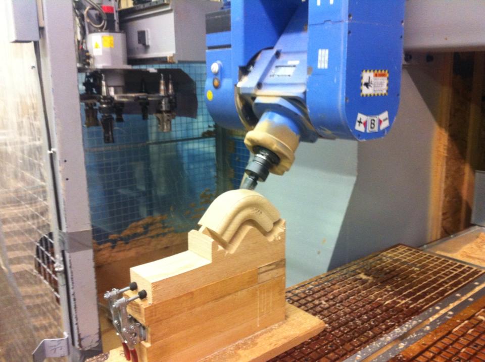

alex
see attached image of the project and machine
View higher quality, full size image (960 X 717)
View higher quality, full size image (2048 X 1530)

After market pods are available for most if not all nested routers equipped with a grid table, either aluminum or phenolic. After market pods aren't necessary if you don't mind building your own pressure fixture that elevates the material for horizontal work. I have made hundreds of custom fixture over the years out of scrap material. With the vacuum options available you will have no problem, just make sure you state your intentions when specifying the machine, new or used. Some basic, open plenum tables will not get you what you obviously need. An optional manifold to access vacuum may also be of interest to you. This makes angled or vertical fixture easier to plumb vacuum to.
