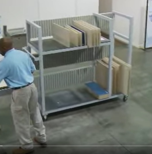

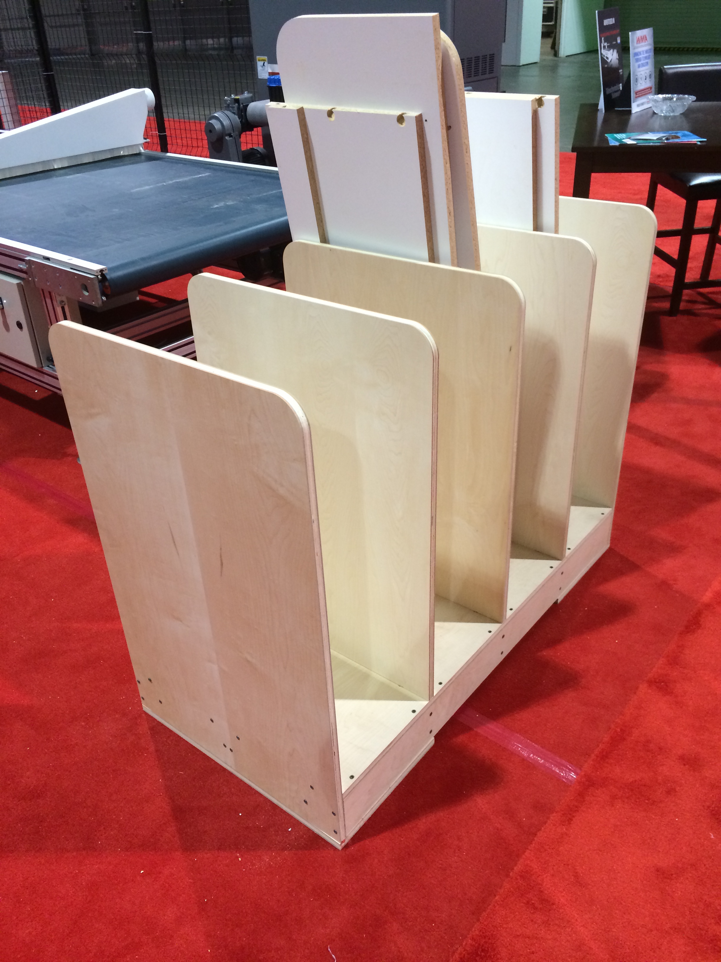

Just entered the wonderful world of CNC. We now find ourselves pushing out lots of jobs (frameless kitchens mostly) with no great way of stacking and sorting.
I have seen this cart (pic attached) which I like the idea of, just wondering if anyone could share ideas or things to watch out for. I like the vertical slots so you can slide the parts into them and then hold themselves upright.
We used to have a giant sorting rack that just didn't seem to work for us. I'm preferring to try and keep the job lots small and focus on flow but sometimes it just makes more sense to cut a whole kitchen or two at once with its doors all ready to go. Especially since the CNC produces quicker then the factory can assemble.
Thankyou

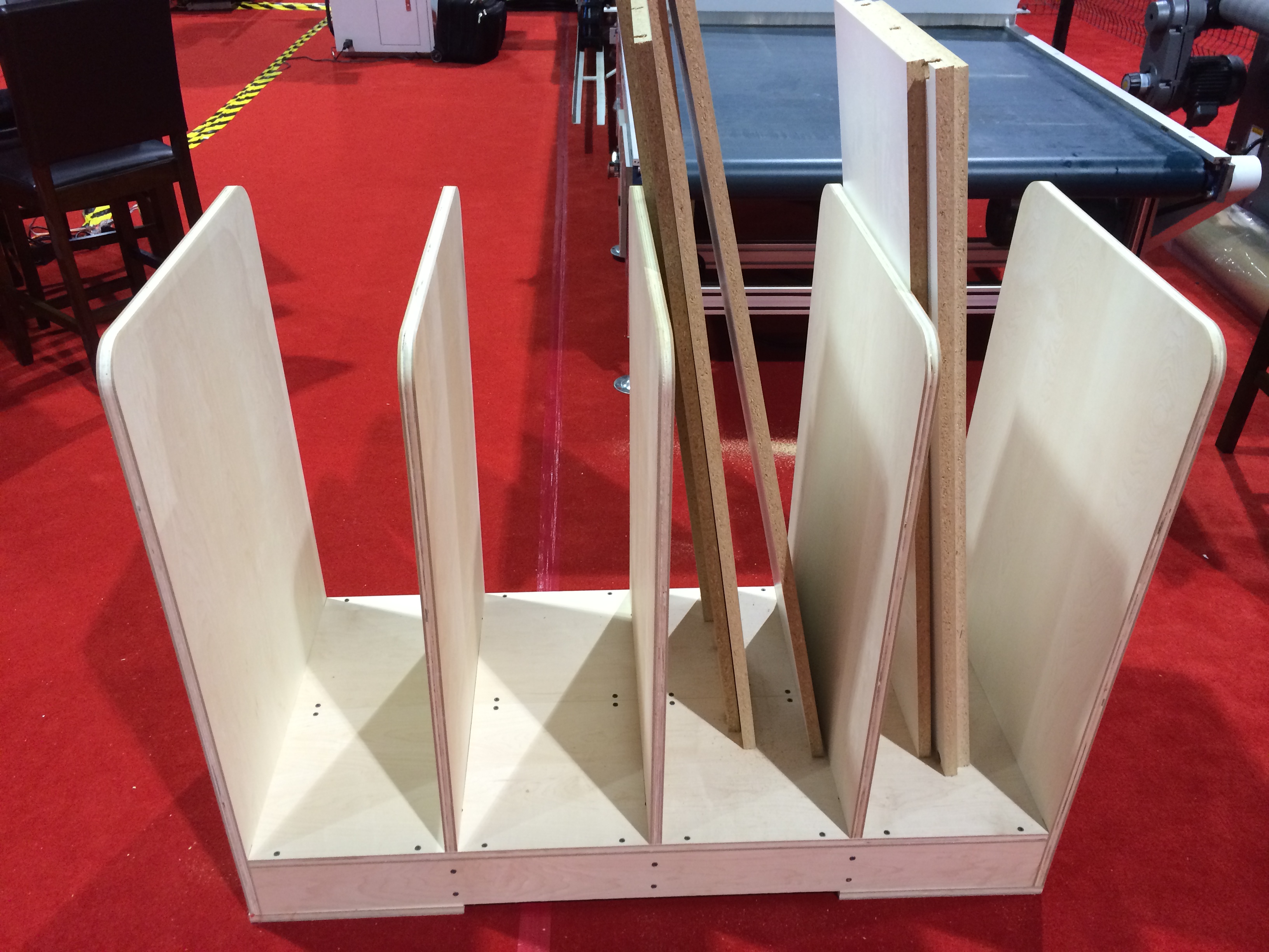

6/21/16       #6: CNC job cart ...
We made ours out of plywood for durability. A bottom, two sides, a back and vertical dividers. Put some casters on the bottom and we are in business. We don't keep them in cabinet kits, but some carts are loaded only with parts that get edgebanding next, while others go straight to glue and dowel or final assembly.

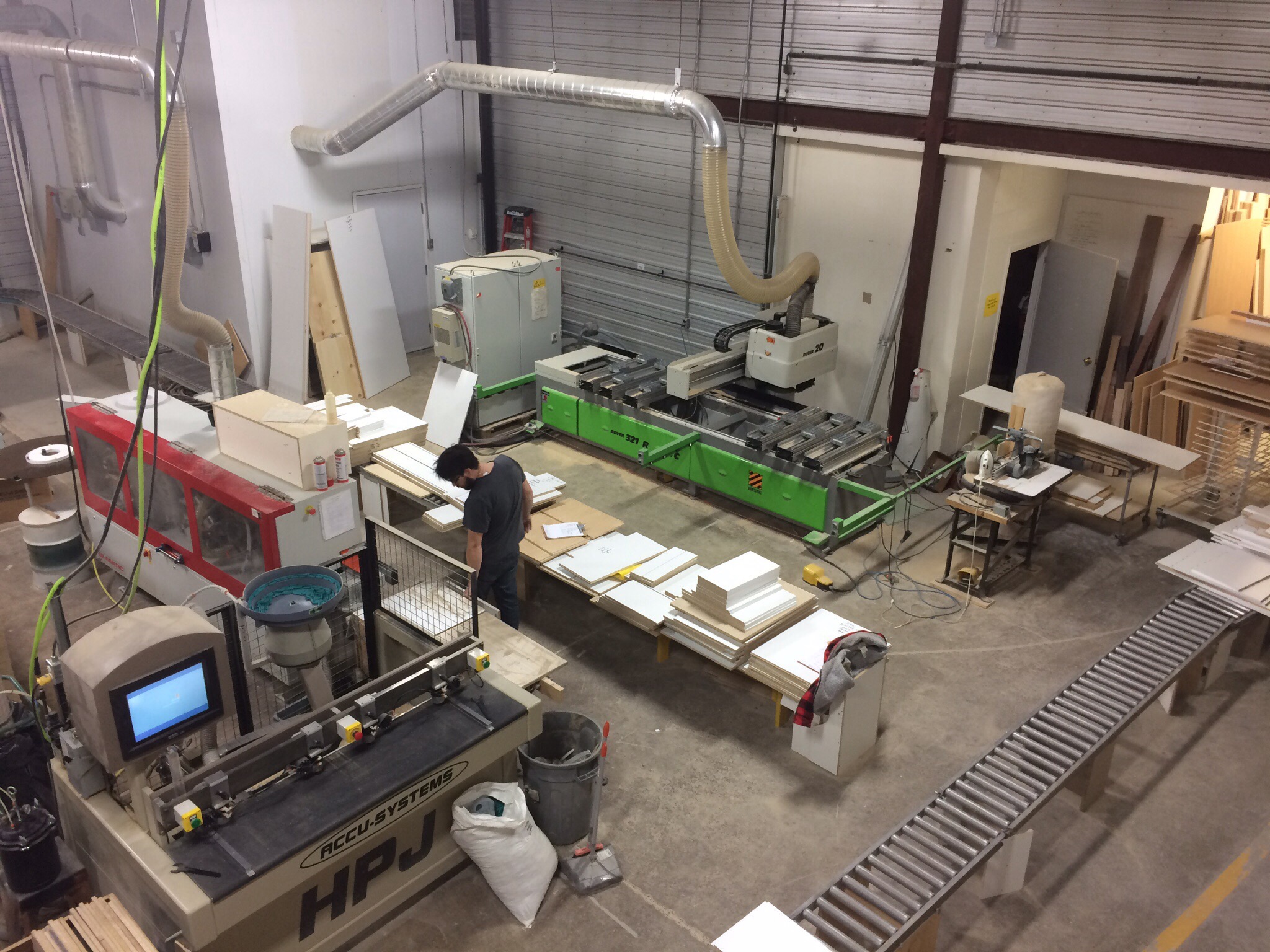

Brian

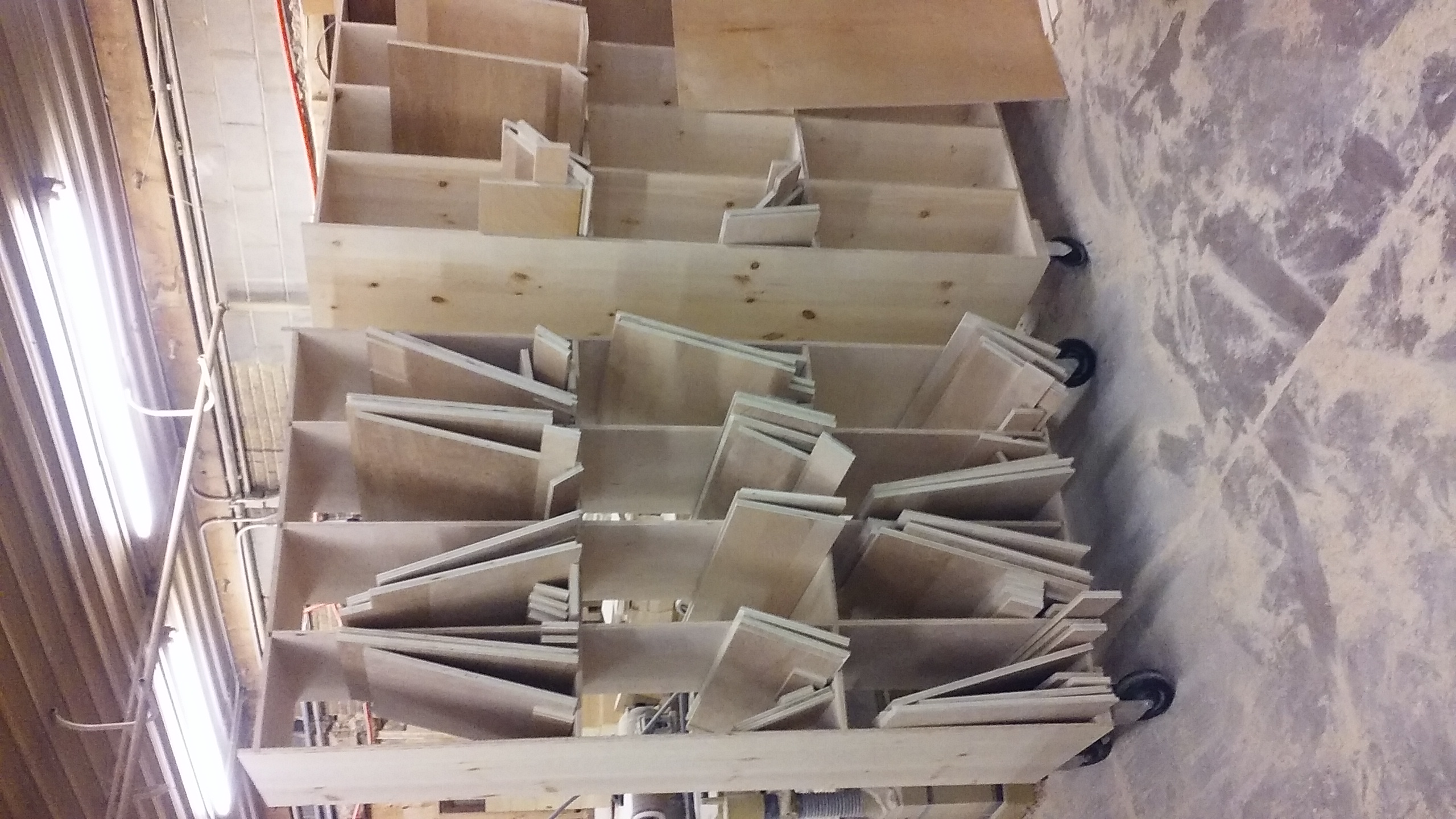

we built something similar to this on wheels.

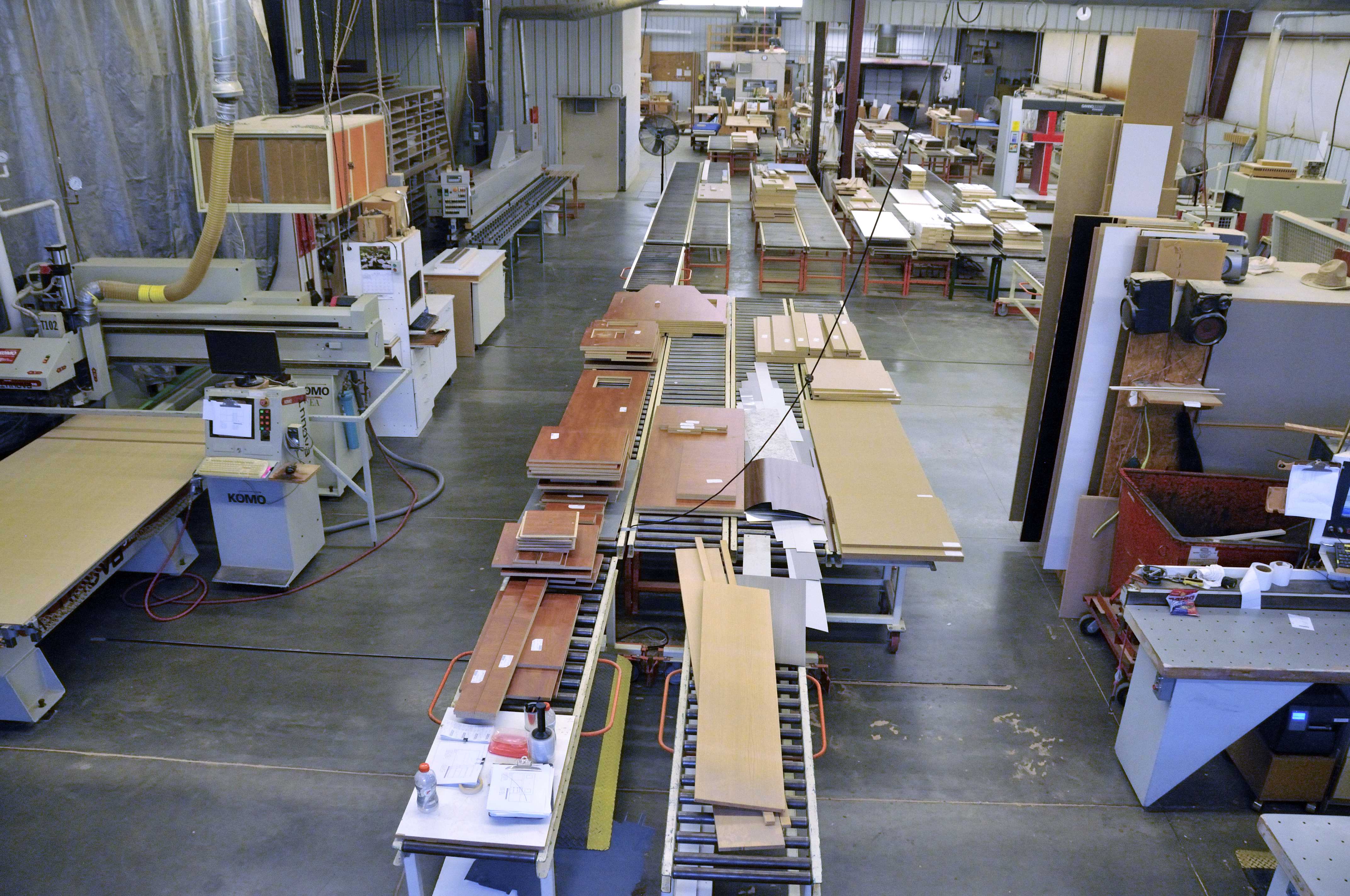

7/2/16       #13: CNC job cart ...
Photos of our conveyor system. 1st one Router & beam saw input. 2nd one Bander on left, assembly straight ahead, doweling & clamping rt. 3rd 10, 10' sections of sorted parts for each of the assembly benches. Not seen, the final assembly station for case clamped stuff. 450' + 5 transfer cars. Tracks are recessed into the floor. Works for the diverse assortment of things made in store fixtures.

7/6/16       #14: CNC job cart ...
Bill  Member
Website: canadianacabinets.com
Nice shop layout. How much space do you have?
7/6/16       #15: CNC job cart ...
Bill, We've got 25,000', You can only see about 7,000 in the 3 photos.

Michael Member
I'm with Mark ..... Hafele sells those red carts for $199 on sale ... $299 if not. On sale now I think. We have nine of them. They work quite well for organizing parts. And keeping the shop floor flexible.
