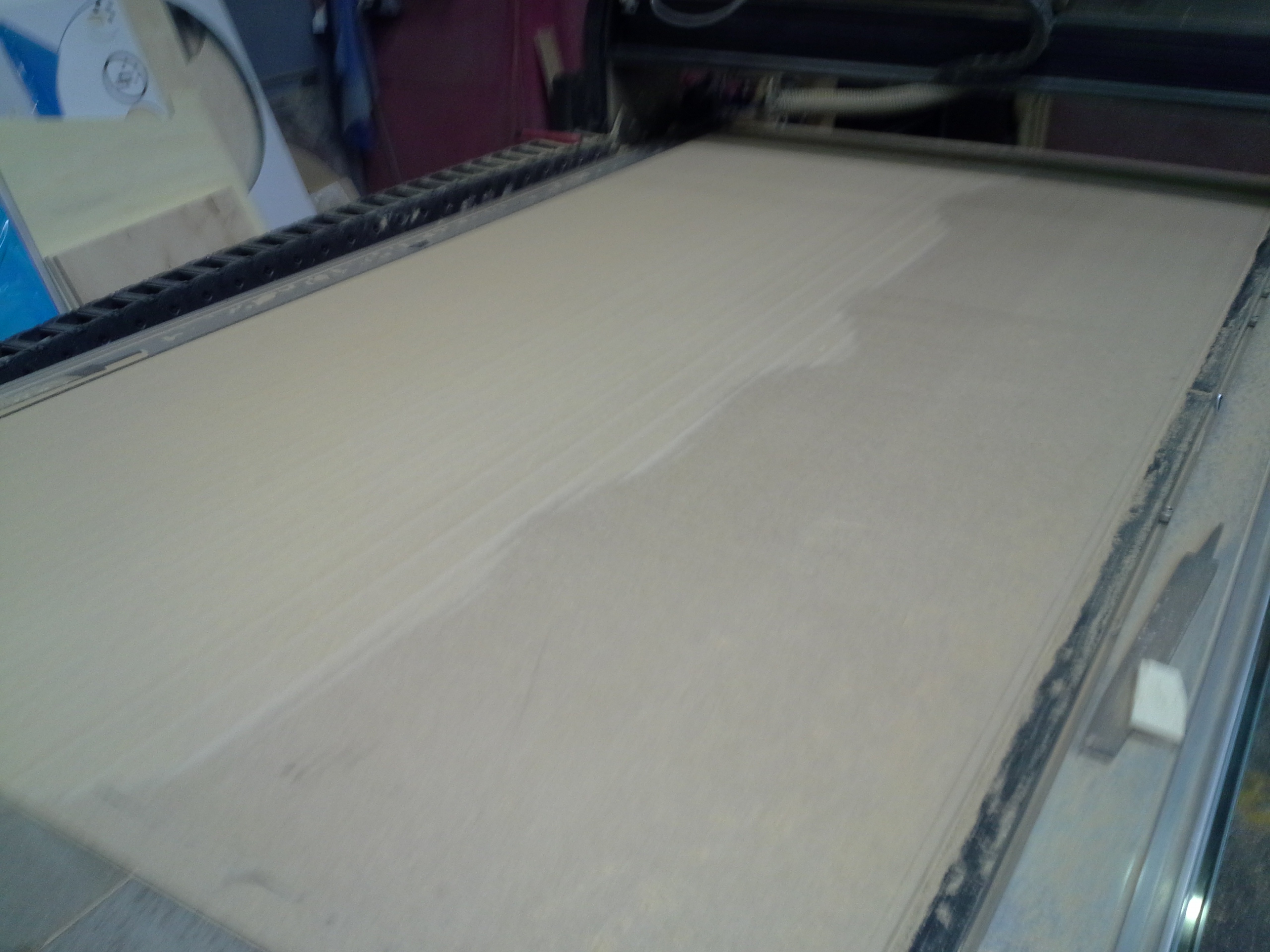

For me, Z was affected most for some reason. X and Y also but the movements are more pronounced in Z. I could run a job and when it finished (I insert a G0 X0 Y0 at the end of each of my jobs) Z would be .1" higher. Sometimes during the job Z would not go all the way down and the end of the job we are left cleaning up parts that weren't fully cut out. Planing my spoil board was futile as you can see in the pic. I consulted all the experts to no avail and stumbled on the link by accident when moving some wires around my desk. EMI is unpredictable in frequency of attacks. There is something you did recently that has caused this change, and it can be a brainbuster tracing all causes. My buddy had the same problem with a huge Trumpf Press brake they traced to a neighboring shop causing interference. Had to run in new AC to solve it. Mine is so sensitive it acted up once again and I traced and verified it was caused by my phone charger. You read correctly, I could cause Z to tick up by plugging my phone in.

The measurements you give indicate the frequency of each tick on the servo. Run a job without the spindle on and see if that helps If your servo's are exposed, or visible and you can put a hand on them as they run, see if there is a tick, you can feel it, as it moves in X or Y. IE, there should be no X move on a line drawn in Y, right? So if you feel the X servo 'tick' during the move in Y, you know it is an EMI.
8/18/16       #13: Servo creep on CNT Motion Router ...
rich
Well I meant to say run a job with lots of straight lines but with spindle OFF, not on, so you can better sense bad moves.

Sounds like a plan. The movements are jerky, one 'tick' at a time and should be detectable. Sorry to overload the forum with my 'experiences' battling this but if it helps anybody tracking down these elusive EMI's then it is worth it.
