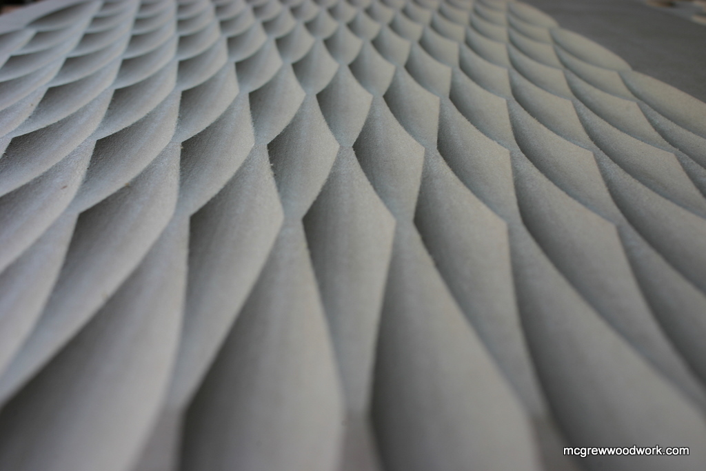

i am new to the cnc word and i want to make a 3d wall panel any tips on what bit to use ? and how can i get a clean design do i have to sand it

Bit choice is based on desired end look, Ball nose .25 to 2" and v bits from 90 and 60 degree .25 wider to 1.5 even 2" wide. i use Aspire software to create patterns and the files are for sale on ebay in some cases.

All of the above are not 3d files, they were made using 2 d toolpaths in Vectrics Vcarve pro or aspire. the base program of each will do this, aspire adds 3d. the demo is full version try it.

MDF, (HDF is better) HDU, and i have even done some in Cast acrylic
