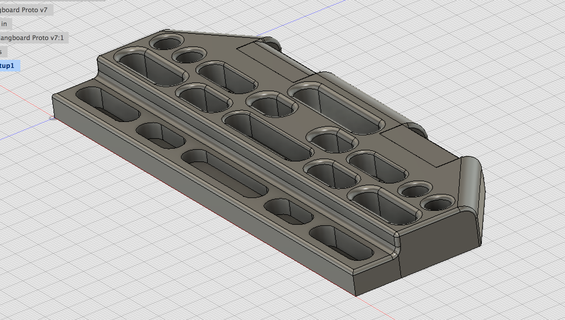

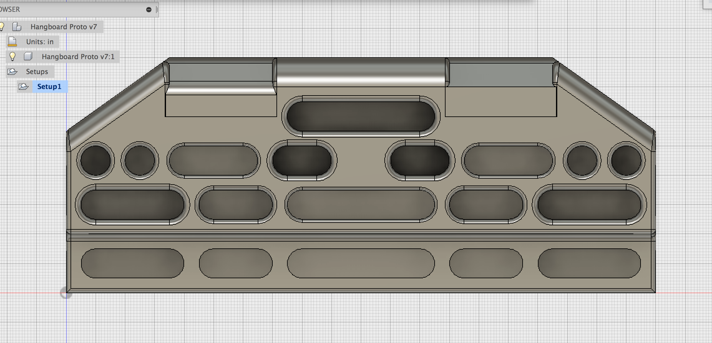

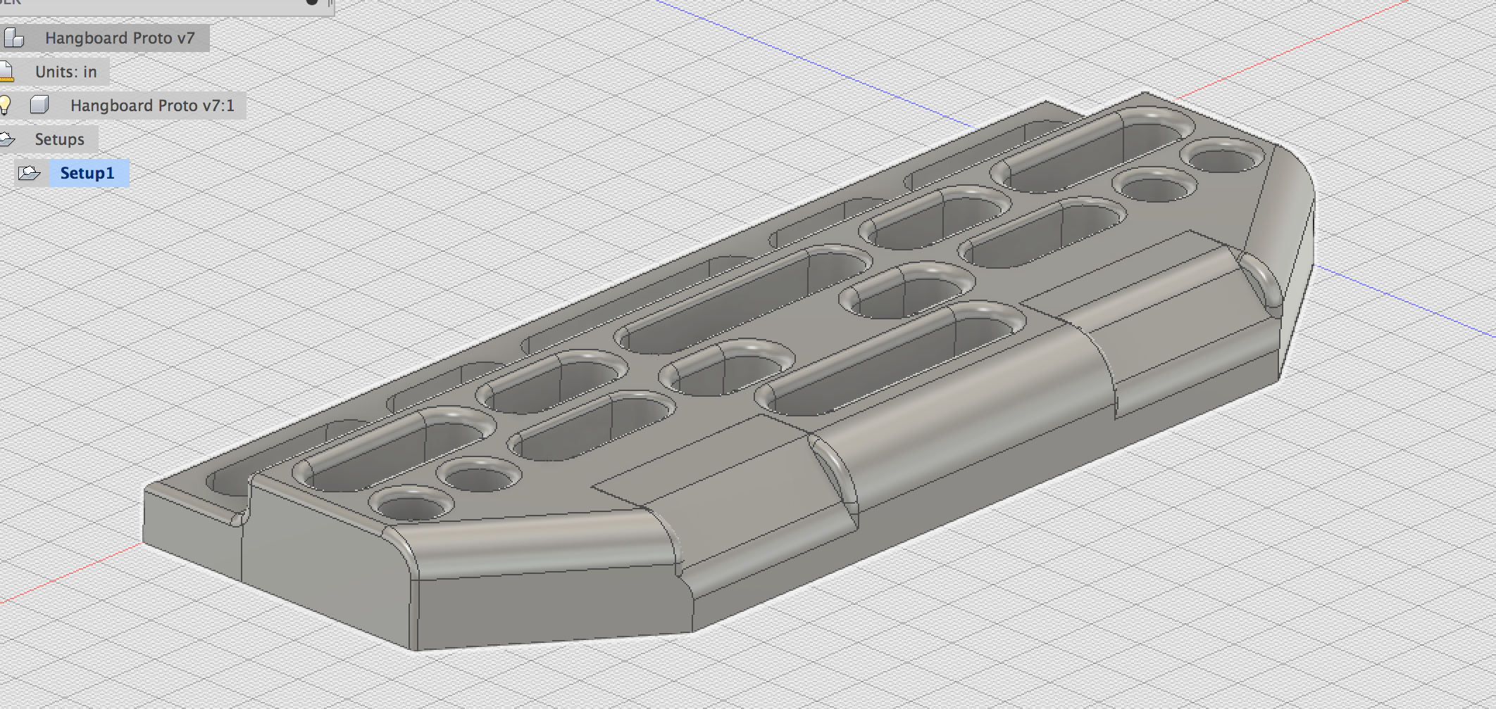

Hello All,
I am having a hard time finding a woodshop that has the CNC capabilities to machine a specific piece. Any advice or help in locating a shop would be greatly appreciated.
Photos of Part: http://imgur.com/gallery/uRGnW
Material: Poplar
20inX9inX1.9in
View higher quality, full size image (1942 X 1102)
View higher quality, full size image (2124 X 1008)
View higher quality, full size image (2282 X 1102)

Where are you?
Not dead easy, but definitely doable with a 3 axis machine.

Nolan,
It appears as though you are designing in Fusion 360? We have had good success running code from Fusion to our Thermwood. Do you need just one piece or many? This would make a difference on setup cost, etc.

If you are willing send me the file for test run. i see nothing wrong with it but will have to see file structure. it is doable

If you do not need the edge easings to be perfect you could save yourself a little money doing the vertical face and corner easings with a hand router. All of the horizontal easings are easy, but some of the vertical ones will take a bit more programming to be more efficient.
I would suggest a tolerance spec for the holes too if something important is to fit in the holes.
