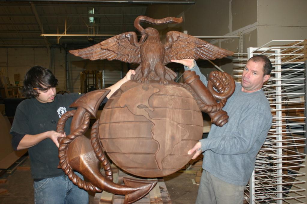

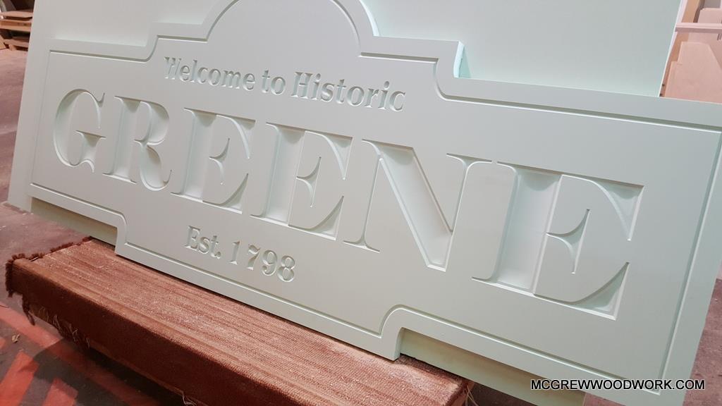

At 5-6" thick I am sure you have worked toolpathing and machine capabilities, just a thought in deep carve and i have done a good bit of it.
i would use a 15# or better good grade of HDU suggested so far. how "outside" is it ?
The EGA is 4.5" thick cut in two slices using 3" as the base
