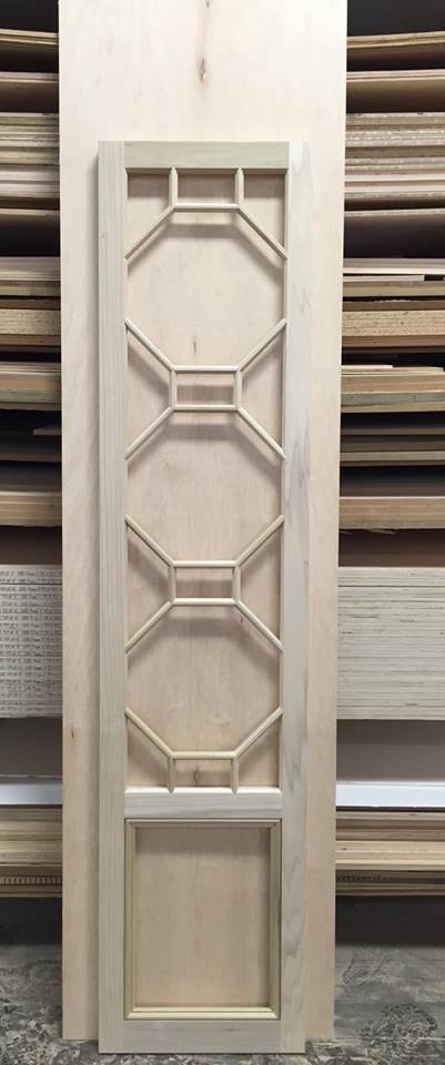

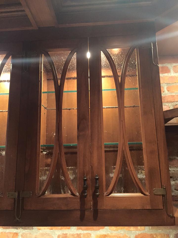

The first two pictures are done with traditional cope and stick ....and the 3rd was done on my cnc
David, you are correct. How the heck will I fixture a small muntin bar so it doesn't go flying.

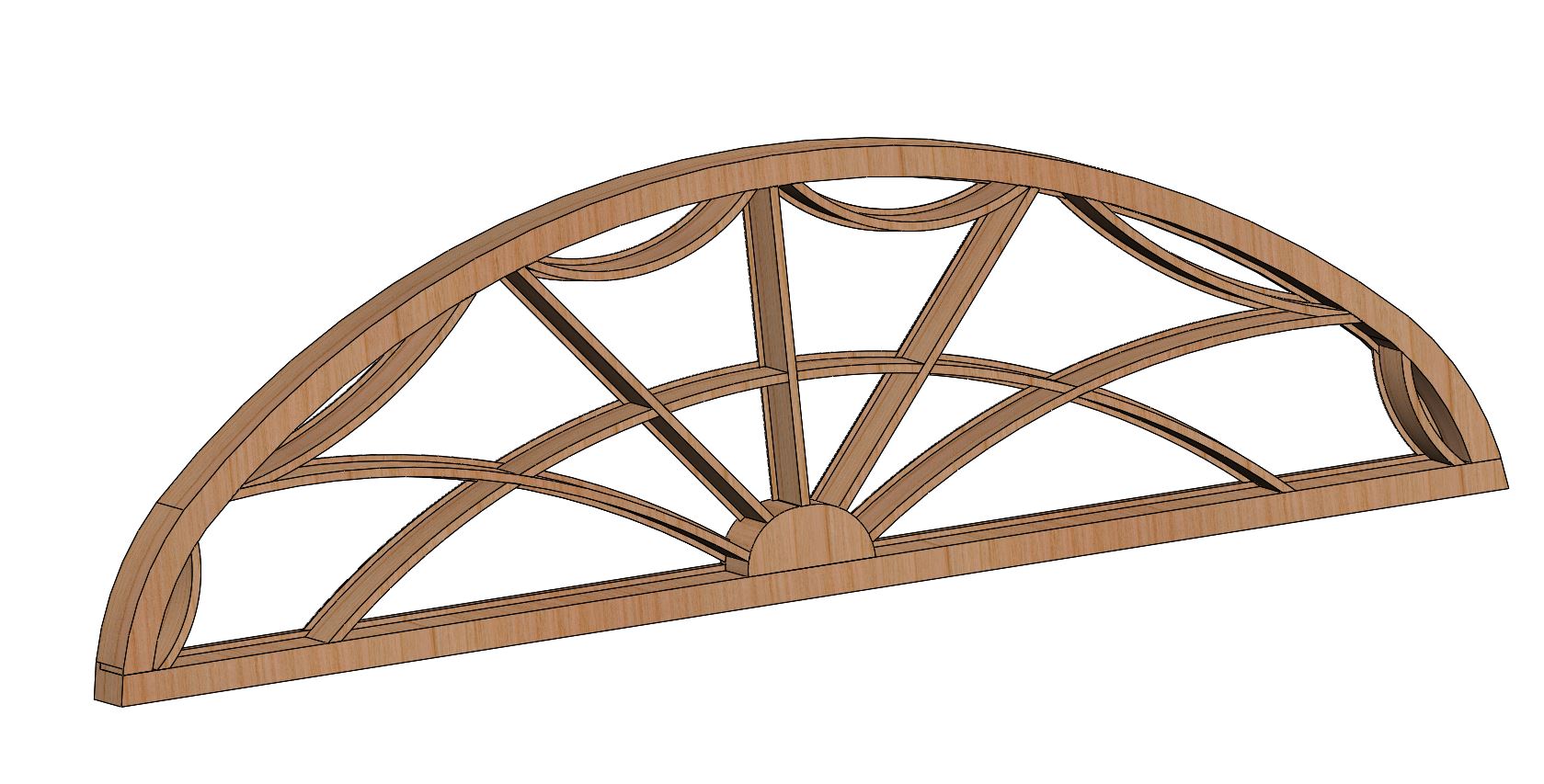

As with anything in CNC, it is in the programming. Disregarding the running times on the CNC, how long would it take to draw and program the elliptical arch window in the above photos?

If you do want a model this does not take as long as you would think if you have the correct software. I find it helpful to see the parts, but some do not need that. I was curious how long it would take to model David's window, so I gave it a try. In about 45min I am well on my way. It is not perfect, but with a proper set of drawings showing some key dimensions it would be. I am far from being a millennial, but I do have experience 3D modeling.
I think trying to figure out how to cut David's parts would be a fun challenge. The first time would be a hair puller, but after that I bet you could copy a lot of the strategies to other projects. I suspect 4 - 6hr would make a good dent into creating the tool paths since many are mirror images, but I forsee some time making fixtures that could add some time and headache.

I think it's important to underscore for those that don't have CAD/CAM experience that a 3D model is a nice visual aid, but is irrelevant to the process.
They are also not difficult to generate if one wants to have the reference, and I often do so if I have any doubt as to the part intersections or the like.
Mr. Sochar's example has only three radius parts (Brad has complicated it a bit my making one of the radial muntins radiused, which in addition changes the length of one the short decorative muntins) - the outer frame is one, the individual decorative muntins between radial muntins is two, and the continuous (though manufactured in parts) elliptical muntin that is a simple offset of the outer frame is three. I'm assuming the straight parts would be manufactured on the shaper. Which is not to say this is a quick and easy job, but there is a lot of symmetry which would make the programming faster than one might think. Actual manufacture, including fixturing, would take some time, but I think I could draw, program and cut the parts, excluding assembly, in a 10 hour day.
