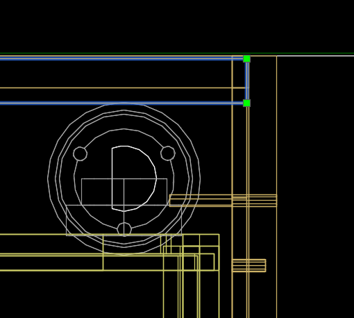

I'm fairly green to Microvellum and I am having trouble setting the Globals to create a lock dado on cabinet backs. Backs are 19mm thick and the machining is showing up correctly on the sides, top and bottom but not showing up on the back. Any ideas? I'm sure it's a simple solution but I am missing it.....

Usually when I have machining not showing it is a result of either an incorrect material thickness or the parts are not positioned correctly in relation to the part with the token.
