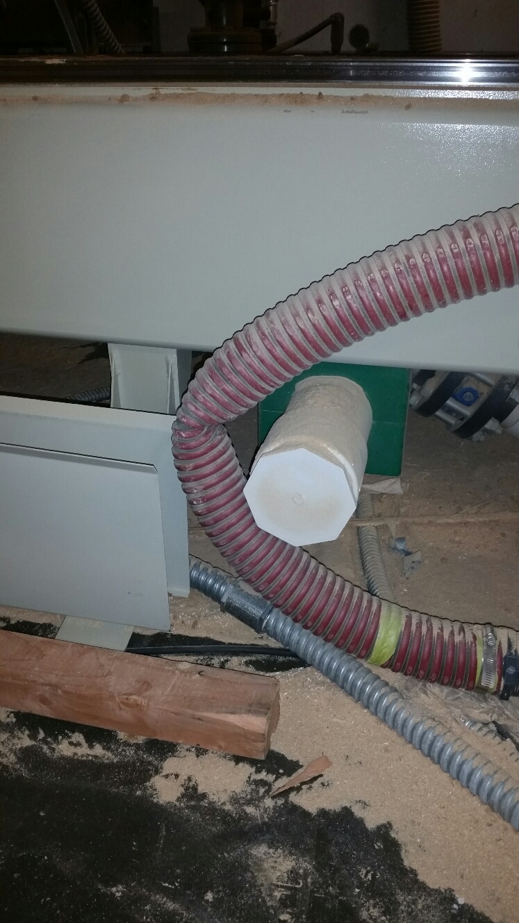

Is there an alternate source for vacuum hose that is less money than buying direct from my manufacturer? This is from a Komo VR 510

Many sources out there. McMaster-Carr is one but there are also some manufacturers that will sell direct. Air Handling Systems is another.
Just do an online search.

Any reason not to use PVC

Also if you are replacing the hose due only to the kink then just cut and splice it with a PVC or metal coupling.
I do understand that the photo may only be to show the type of hose and you may need it elsewhere as well.

We just buy ours from the manufacturer(Northwood) since they last so long. I think I have gone through 3 sets over 13 years. Each time we order, they are a little different and last longer. I guess they are sourcing better quality hoses as they become available. To the other poster, PVC would not work since that looks to be a moving table machine. The hose has to move with the table and that generates wear over time.

Find a company that supplies hose to vacuum trucks.

cut and splice save some cash

For our Komo we used a hose from Abbott Rubber (abbottrubber.com). The item we needed was (verify the diameter you require) Part # 1220-2500 - Green Black 2-1/2" ID A/W Suction Hose.
Only difference is hose is bright green instead of red. Cost savings even with shipping was substantial. Hose from Abbott has been installed for a few months without any issue. Minimum order was 15' so we did have to cut the hose down to match length we needed.
