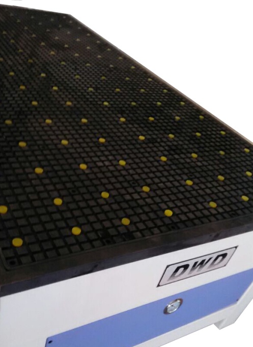

Lei Member
Website: http://www.dwd-cnc.com
I have been service engineer of cnc for 6 years,and i saw many clients who cut this kind panel. In my opinion,it depends on two things: first ,the type of the vacuum table--i suggest double-layer vacuum table with more than 86 vacuum holes.Second,the power of the vacuum pump, according to my clients, for 400*40mm panel, 7.5kw vacuum pump is ok(4*8 cnc)
View higher quality, full size image (497 X 680)
