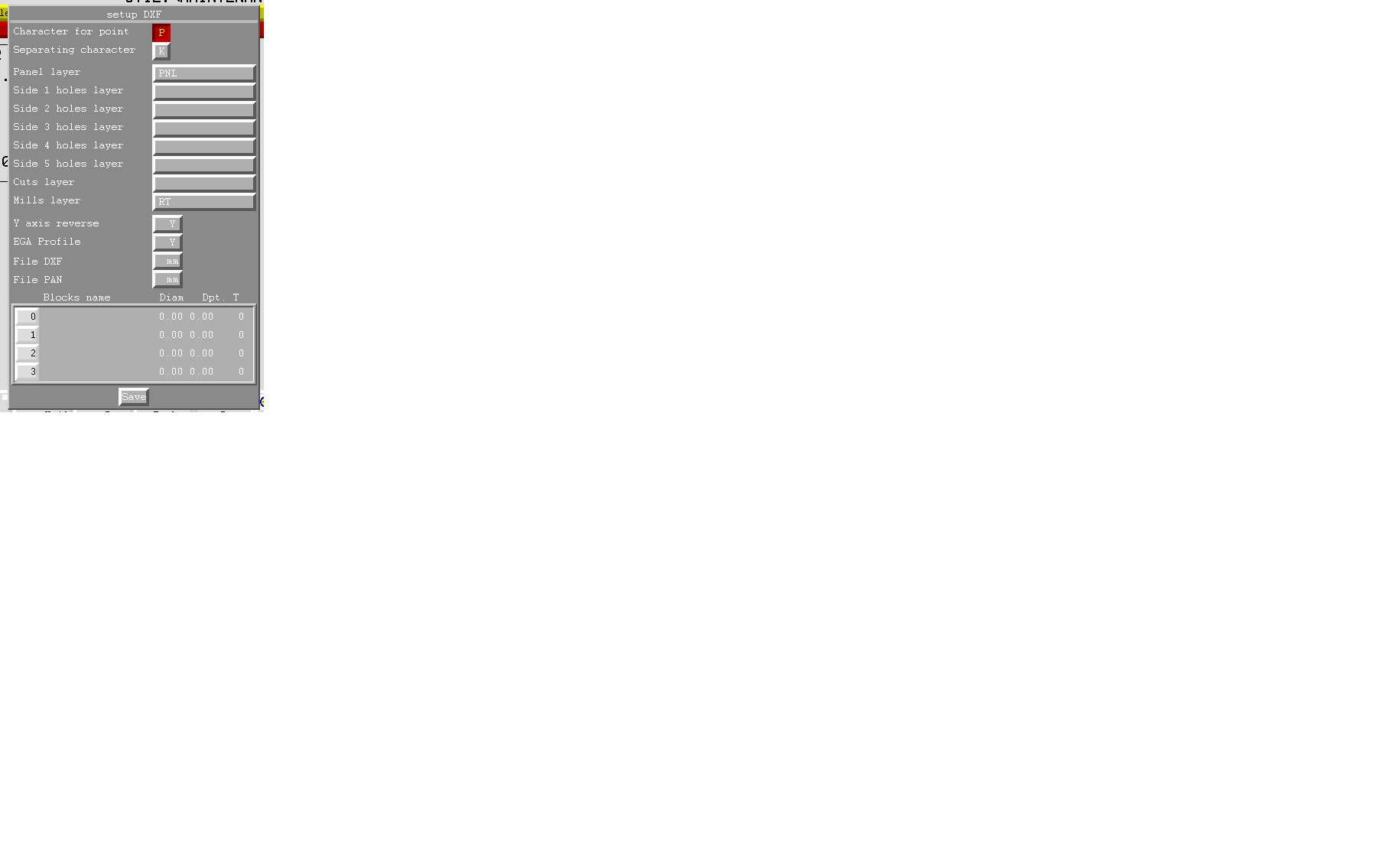

The drawing must be a polylines, units metric and I have found it works best to keep the layer names as simple as possible ( PNL (panel layer), RT (route layer),etc.) when specifying on the DXF set up page within the NC500 environment. I attempted to upload a screenshot of how I have it set on my offline version of the software, we will see how that goes.
