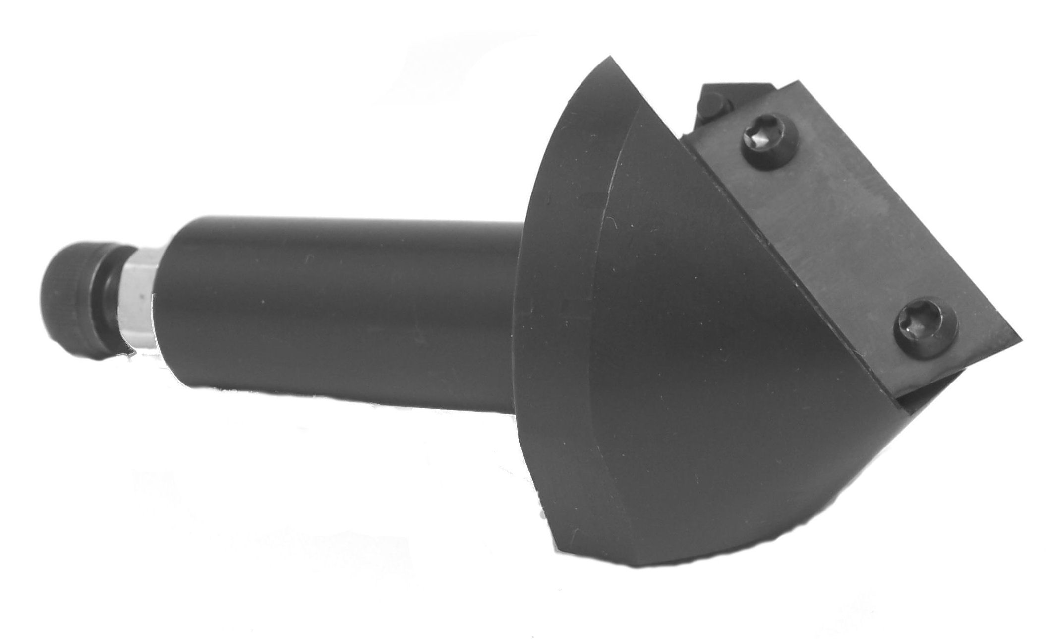

2/3/17       #8: Mitering with CNC router ...
I would highly recommend the 91 deg. Much better for miter folding.
Pg 115 of our catalog
View higher quality, full size image (2110 X 1288)
