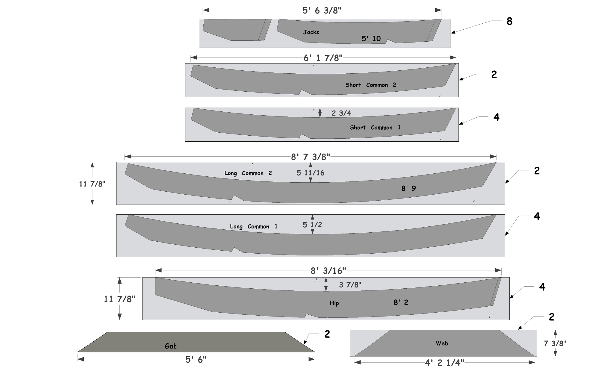

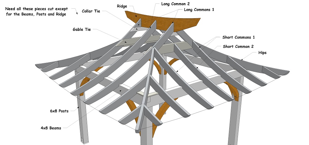

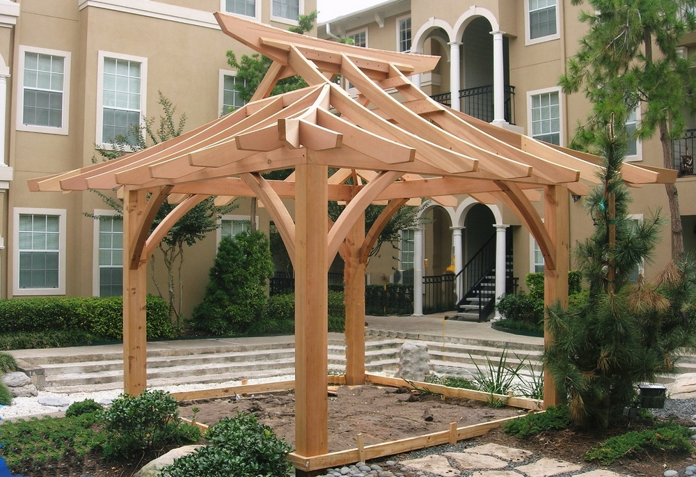

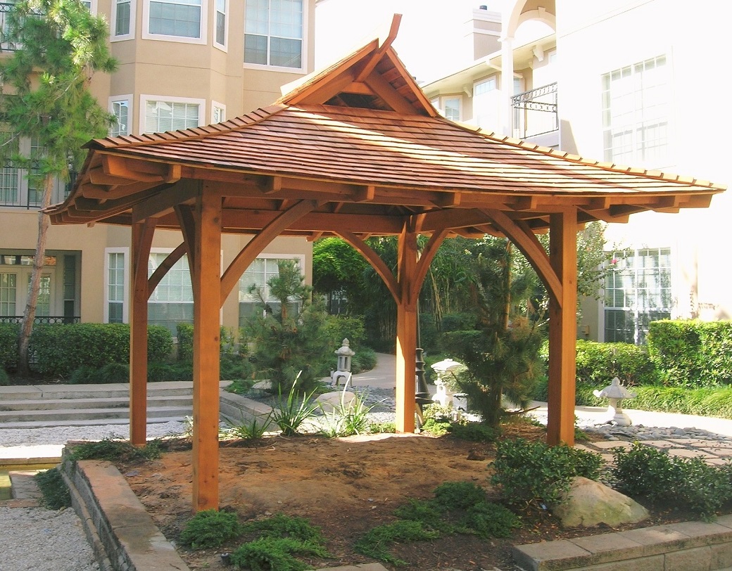

I build these azumaya / gazebos with a 'draped' roof,
http://woodsshop.com/Gazebo_Kits/Gazebo_Kit.htm
and all the rafters and roof pieces need to be cut by CNC as each is different. Most all the pieces are cut from 2x12 clear KD VG western red cedar, 1 5/8" thick. Some of the rafters are 8' 8" long.
I have the dxf files, and I do about one of these a month.

Here's the actual count, would be nice if they could wide belt all the pieces.

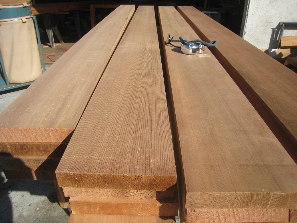

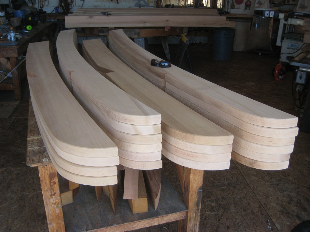

My usual cnc shop has been doing a pretty good job cutting this VG wr cedar, only real problems happen when the wood is still a little wet inside, leaving a fuzzy cut.
But now I might be taking this to a new shop. What would be the best type of 1/2" router bit to use on this (sometimes) KD, VG splintery cedar?
two, or three flute, downcut, upcut? Brand of router bit??
