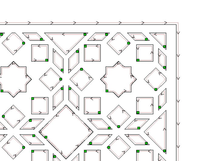

Hi,
1st time cutting 1/2 Baltic Birch plywood using 1/4 onsrud compression bit, can I cut it one or two paths.
My RPM is 16000 with 320 IPM
Thank you.

I'd say your rpm is low for a 1/4" bit. If you think about doing two passes, why use a compression bit? Any commercial machine can easily do it in one pass, but I have no idea what machine or spindle you have.

I am using comp bit because I want a clean cut both sides.
it is Omnitech 4X8 8 tool changer and 10HP spindle.
I just do not want to brake the bit.
you think the 1/4 bit will handle the one path in ply or mdf? with 320 IPM?

I think the feedrate is slow.
How large are the pieces?

it is not a straight cut, all opening between 2 or 3" with tide corners as you can see.

You're not going to get to 320 IPM on that part except on the perimeter. The cuts are too short.
You're going to lose a lot of vacuum hold down as well.
I would do one pass at 300IPM full depth less 0.030 and the last pass at full depth with a 0.125 bit at 150 IPM or so.

I have cut the same one on 1/4 with one path and had it down using fastcap double sided tape pus the vacuum, this tap works great, it was too hard to remove the part after cutting, it was stuck very good to mdf table.

I agree with Dropout, onion skin is the best way to cut this. Make sure your collets are new or in good shape also to help with breaking tools.

I worry about the last pass with the. 125" you will be taking a full depth cut momentarily at each inside corner. Make sure you have sufficient flute length and if a bit were to break it would be with sudden full engagement.
8/23/17       #11: one or two ToolPath ...
If you superimpose a 1/8 and a 1/4 circle you will find that there is not a lot full depth that you are taking out.
I do this in MDF at 1/2 deep at 200 IPM all day long, and that's with a 1/2 bit, not a 1/4.
You may want to slow down a bit, say even to 100 IPM.
I realize that it will take longer to cut, but not as long as breaking a bit, possible ruining the material, and having to start over.
I'm a speed guy - 1100 IPM in melamine, but for this stuff, getting the job done accurately and without damaging material is (I suspect) more important than speed.
If you have lots of these, keep increasing speed until you break the bit. Then use the last setting as your production speed.
