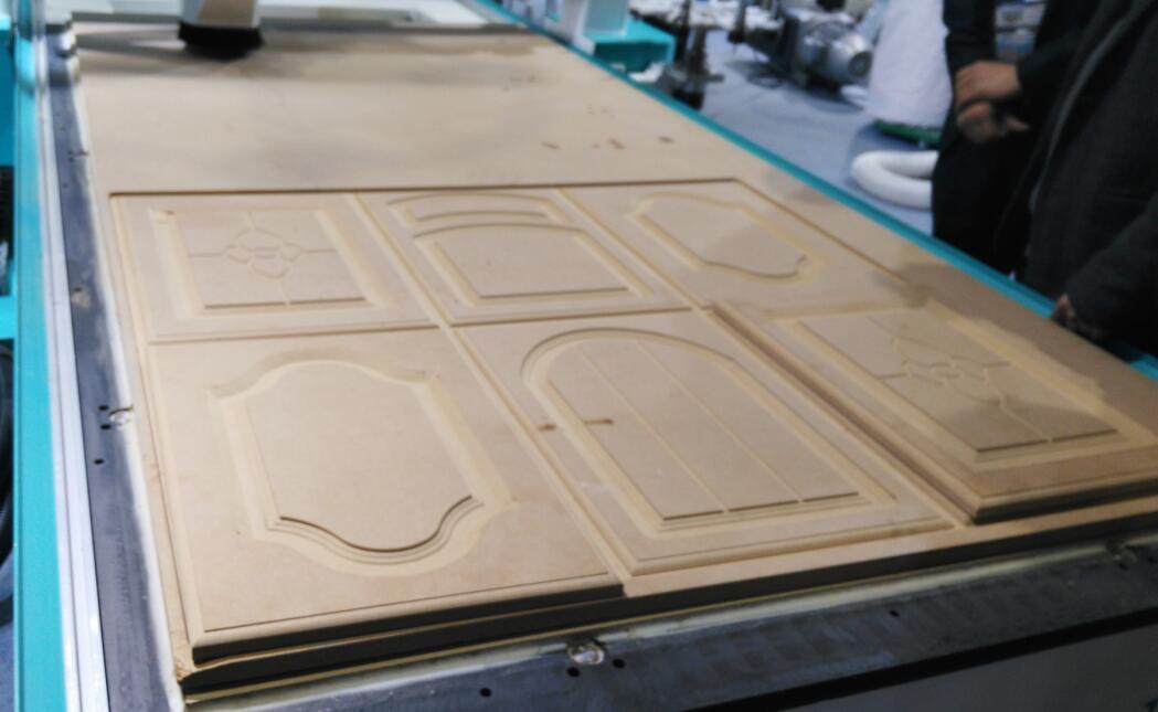

What is a CNC router?
A computer numerical control (CNC) router is a computer-controlled cutting machine related to the hand-held router used for cutting various hard materials, such as wood, composites, aluminum, steel, plastics, glass, and foams.
FORSUN CNC router machines can be used to produce items such as door carvings, interior and exterior decorations, wood panels, signboards, wooden frames, moldings, musical instruments, furniture.
