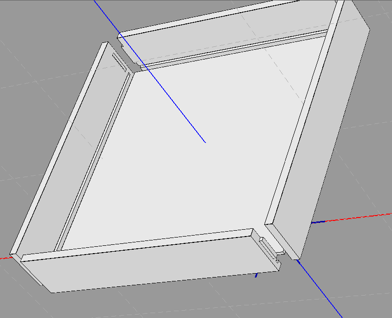

We're considering going to CNC-cut d'boxes, buying KD as part of the cab packages, the boxes of 5/8 melamine, with all four sides edgebanded top only, blind dado corner joints, as shown here.
Fronts and backs need to be flipped for completion of CNC.
How cost-effective might this be versus the relatively high cost dovetailed boxes?

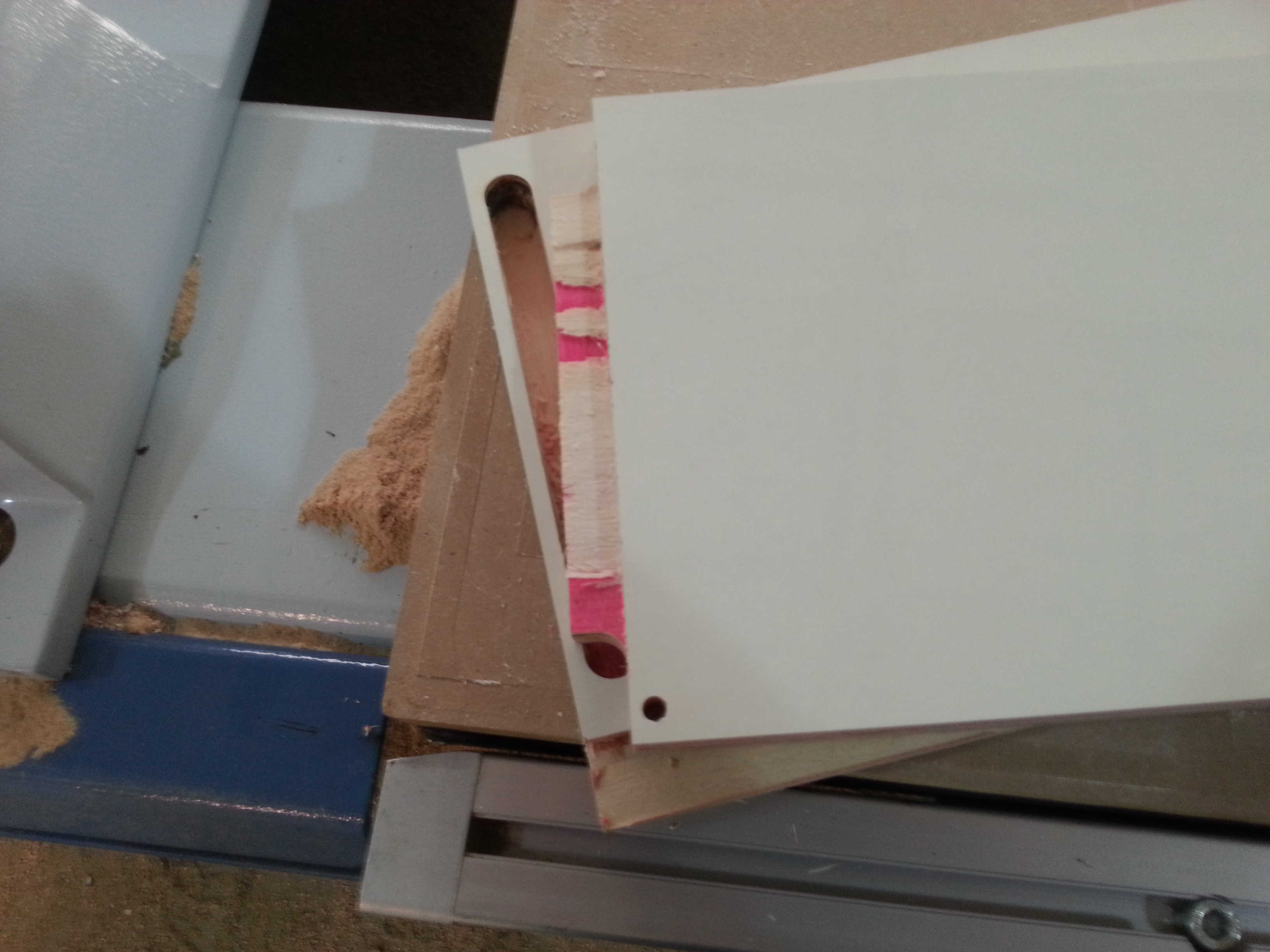

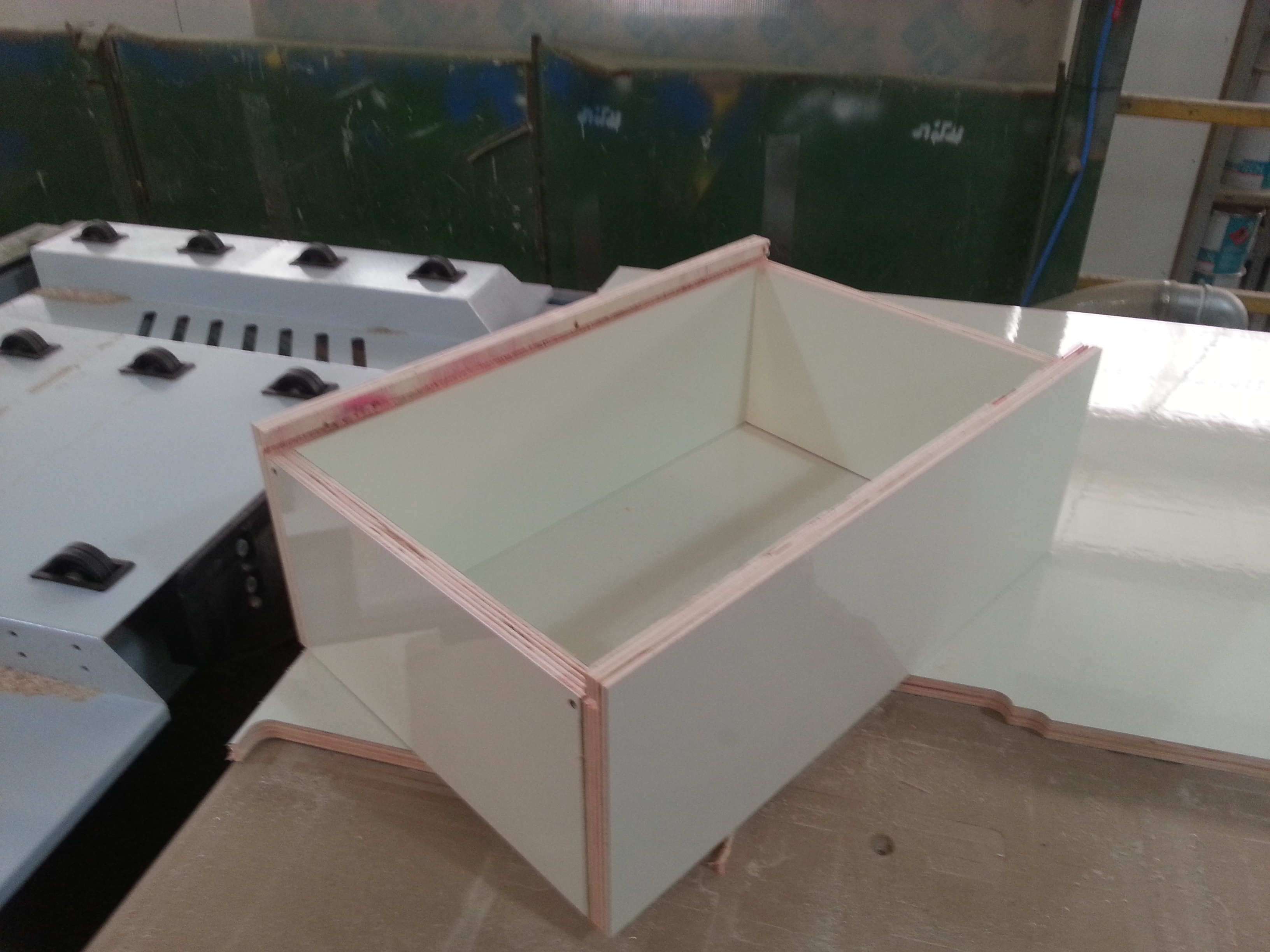

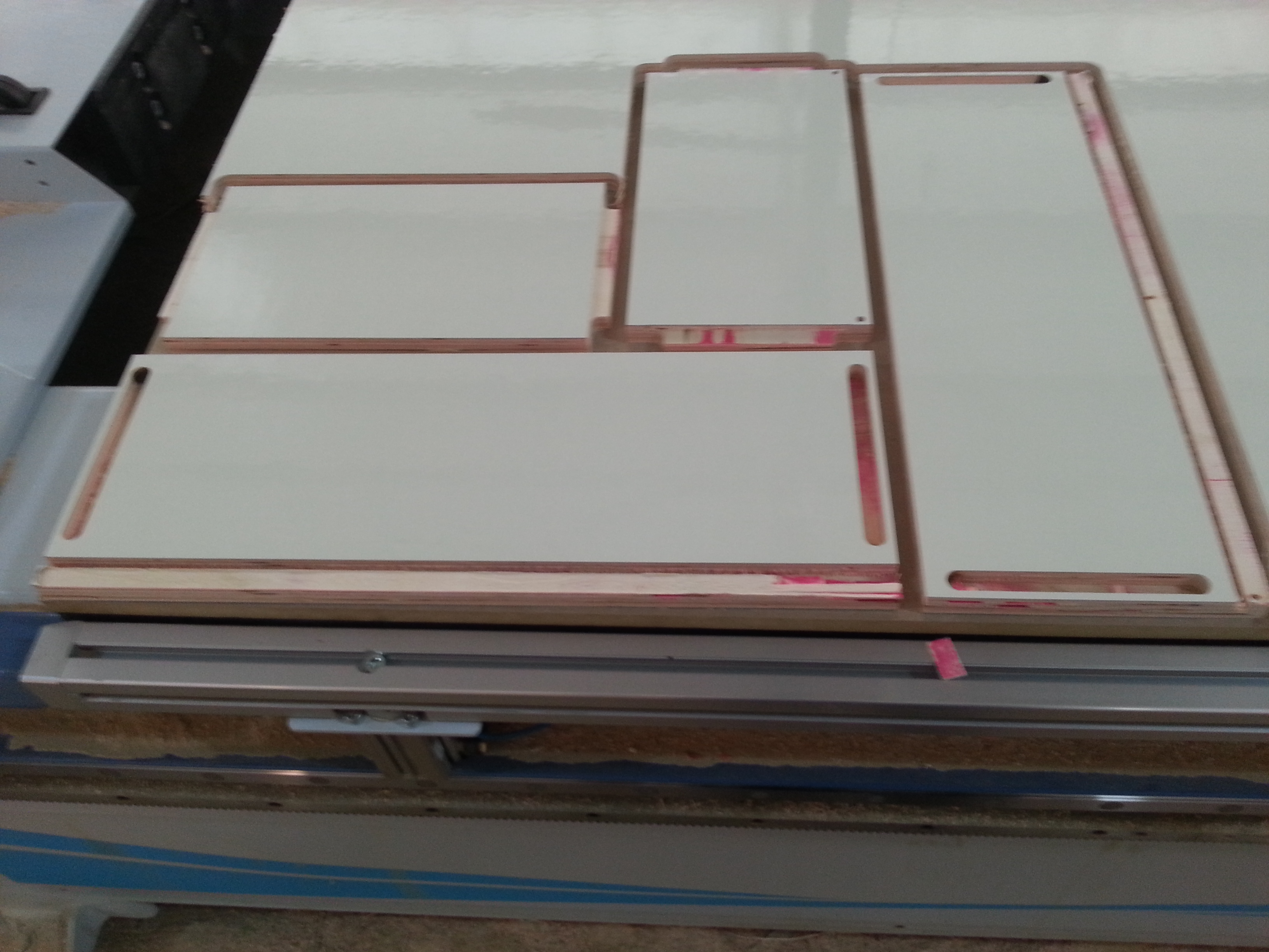

our client use this direct from polyboard
but remember you must work on both side ,you must have software and pp support this method

Robert # yes its multi-ply w/laminate made from china,i dont know the producer ,here (israel) all kitchen boxes build from this material,never use chip board inside kitchen

what holds them together ? just the blind dado and glue?
