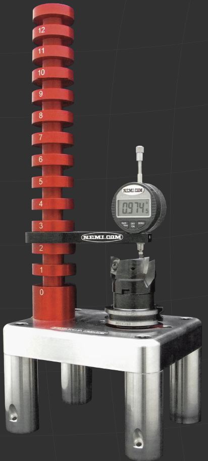

This post prompted me to buy the tool setter in the link.
I set 5 tools this morning and ran a tool test after to make sure I understood what was happening.
The tool tests measured
.01
.01
.02
.02
.03mm off or .00182" at worst.
That is as good as we could get with (potentially) multiple cycles of test cuts. The benefit is the machine can be running while new/sharpened tools are being set up.

Nemi Tool Setter

4/17/18       #11: Tool Presetter ...
Mike Jentges Member
Website: http://nemi.com
NEMI makes an accurate, low cost tool presetter. Several pocket types supported including cat 30, cat 40, and HSK varieties. Check it out...
View higher quality, full size image (412 X 913)
NEMI Toolsetter
