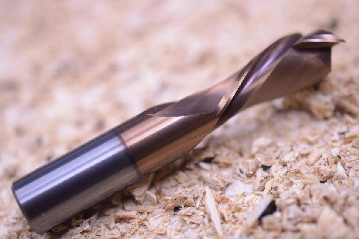

The coated bits will definitely help. The cheaper board has more glue and trash in the board.
