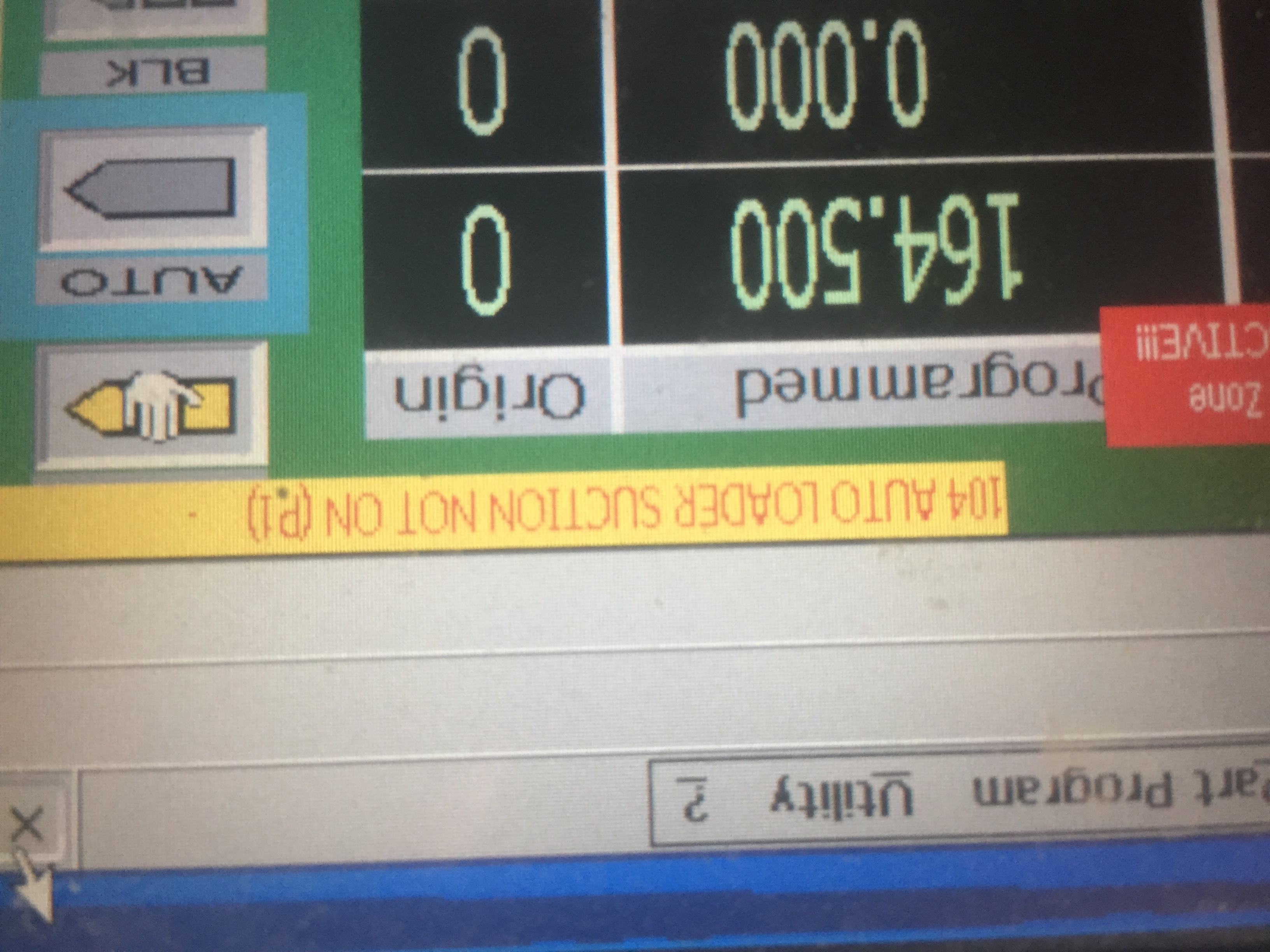

Have a 145T12DA with an auto loader, and although we have suction and the cups are coming down, it simply will not pickup. It stops and the controller displays the attached error message.
Thanks in advance

Grab your electrical schematic and do some basic traces,
No=normally open
Nc=normally closed
If there is no estop then let current pass to material sensor(switch), eye checks for material and then opens electro valve to start suction. (Grab a small flat head and manually reset the electro valve to the suction cups)
Hope this helps.
Chev

Jeff,
There is a pressure switch or sensor saying the dust collection is open and creating suction. Check out the sweeper arm for make sure when it is unloading, it knows the gate is open for the dust collection. There might be a pressure switch that let's it know there is suction.
