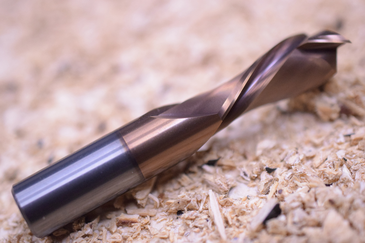

You should be able to get to those feeds without a problem. We have tested our bits (2+2) at those feed rates without a problem.
View higher quality, full size image (1200 X 800)
