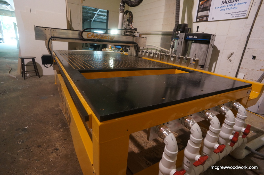

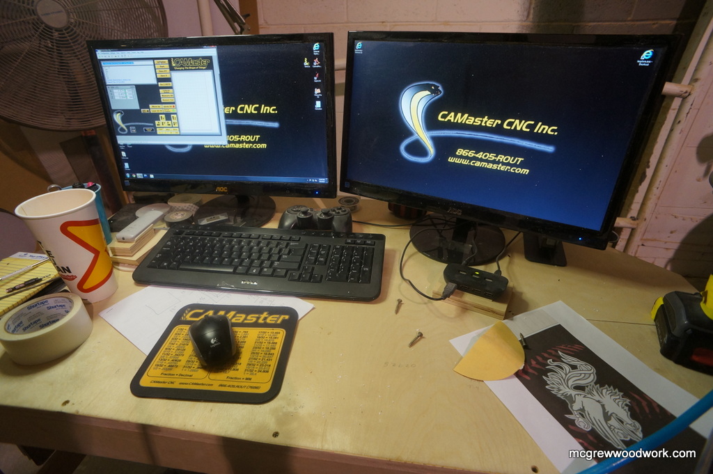

I use a Camaster 508 Cobra ATC, this machine has been in use since 2012 with no breakdowns, Naturally i would offer you give them a look.
That said GO see machines shop owners love showing them off, a great relationship with the machine company will become apparent, you want to look at support, some offer but charge for support, Mine support is lifetime with a very large support forum with 0k in members and 20 k in machine owners, the forums are watched by techs and hardware suppliers offering online support for software as well at no charge, some machines are propietary and will not post online nor offer free support,
Go see sgops, go see plants where they are built, you will need them and remember look for who follows thru, I made my decision base on one simple sentence,, Joey Jarrad was leaving my Shop after my first training session, I joked "Please do not leave me alone with this thing",, He turned and said "Heck you bought one of ours, I will not leave you alone until you are successful" He kept that promise. take a look at www.camheads.org no mater what you buy you will be glad you did.
View higher quality, full size image (1024 X 681)
