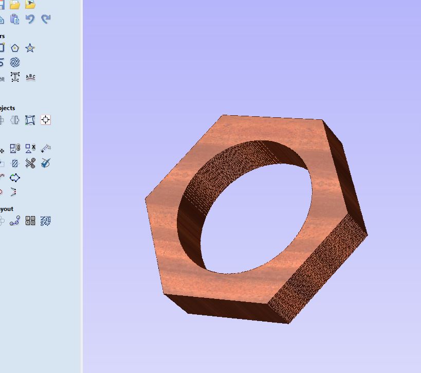

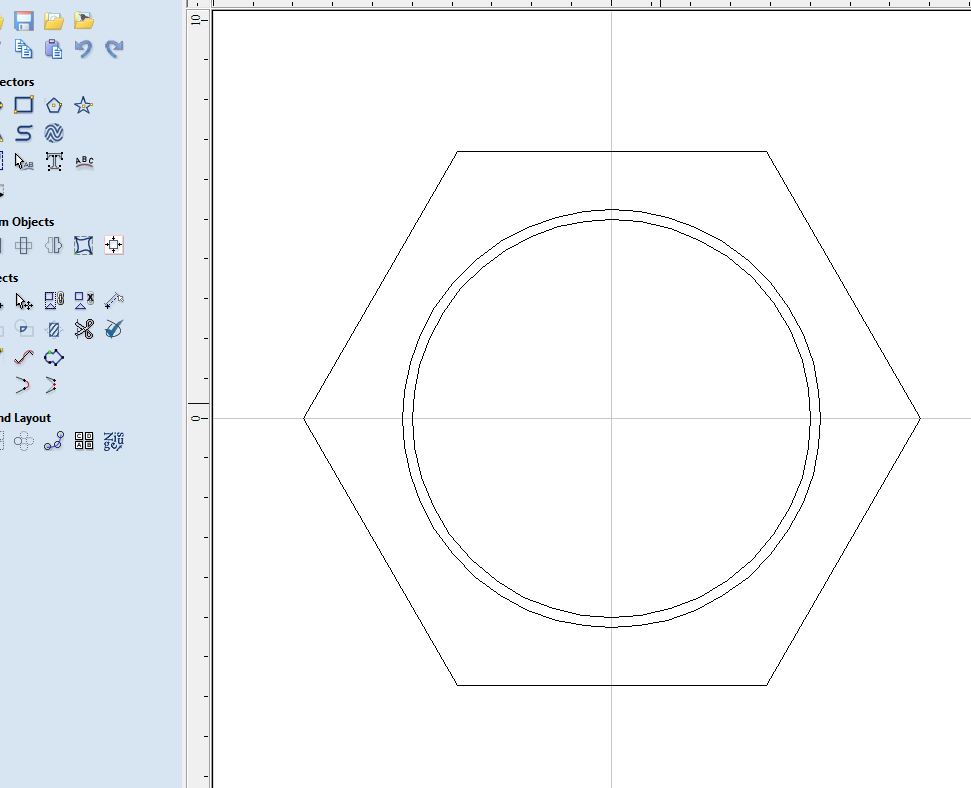

Show US or send me a photo of the end product !
7/13/18       #7: Advice on a CNC for cutting interna ...
james e mcgrew Member
I am no expert as i have no reason to make this, I have seen it done, in the last few seconds i did make the file. the inside thread would just have to be programed in a gadget, might take me a few more minutes but i gotta get to work !
View higher quality, full size image (971 X 788)
View higher quality, full size image (819 X 725)
