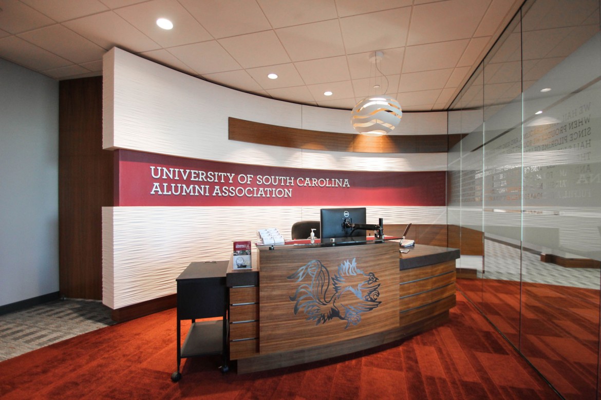

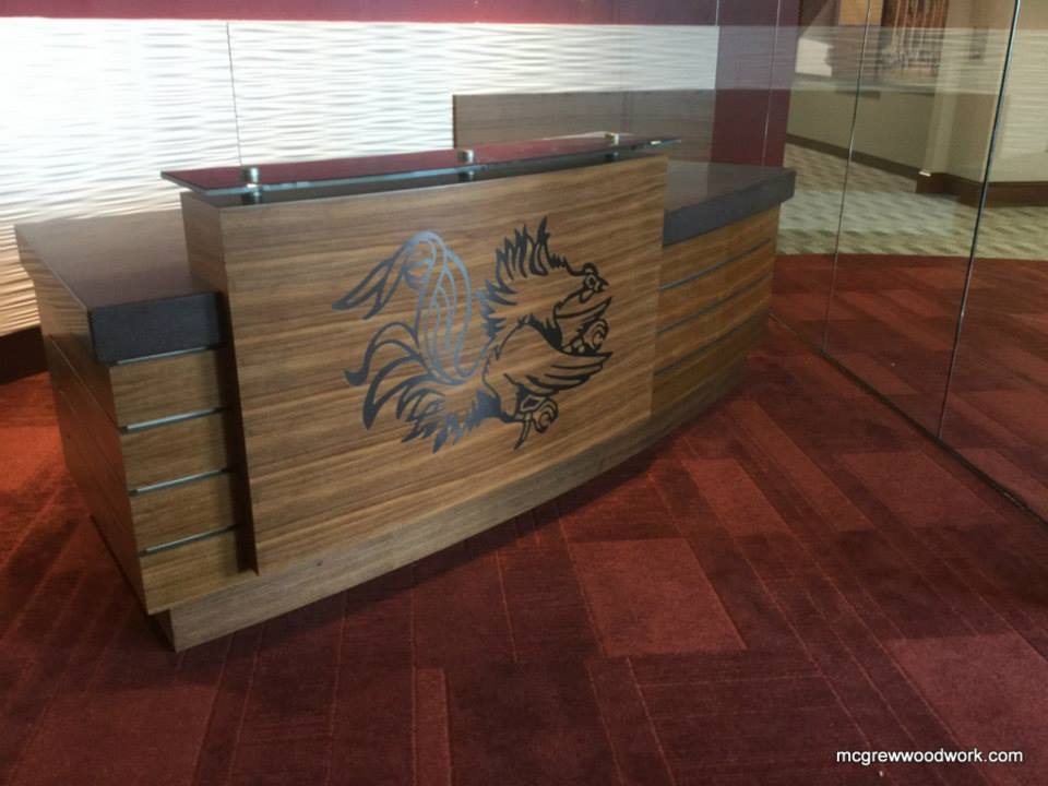

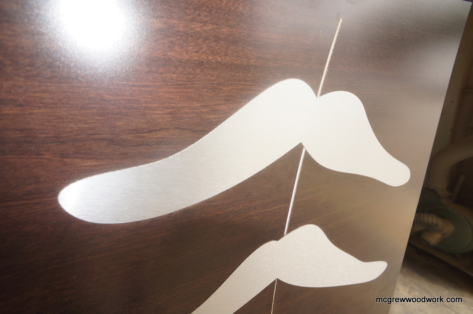

I have done some inlays requiring tight fits, i will adhere the plam to a sheet of melamine with light adhesive, then cut with a .125 downshear, on the inlays i cut male first and female last, so i can adjust fit.
