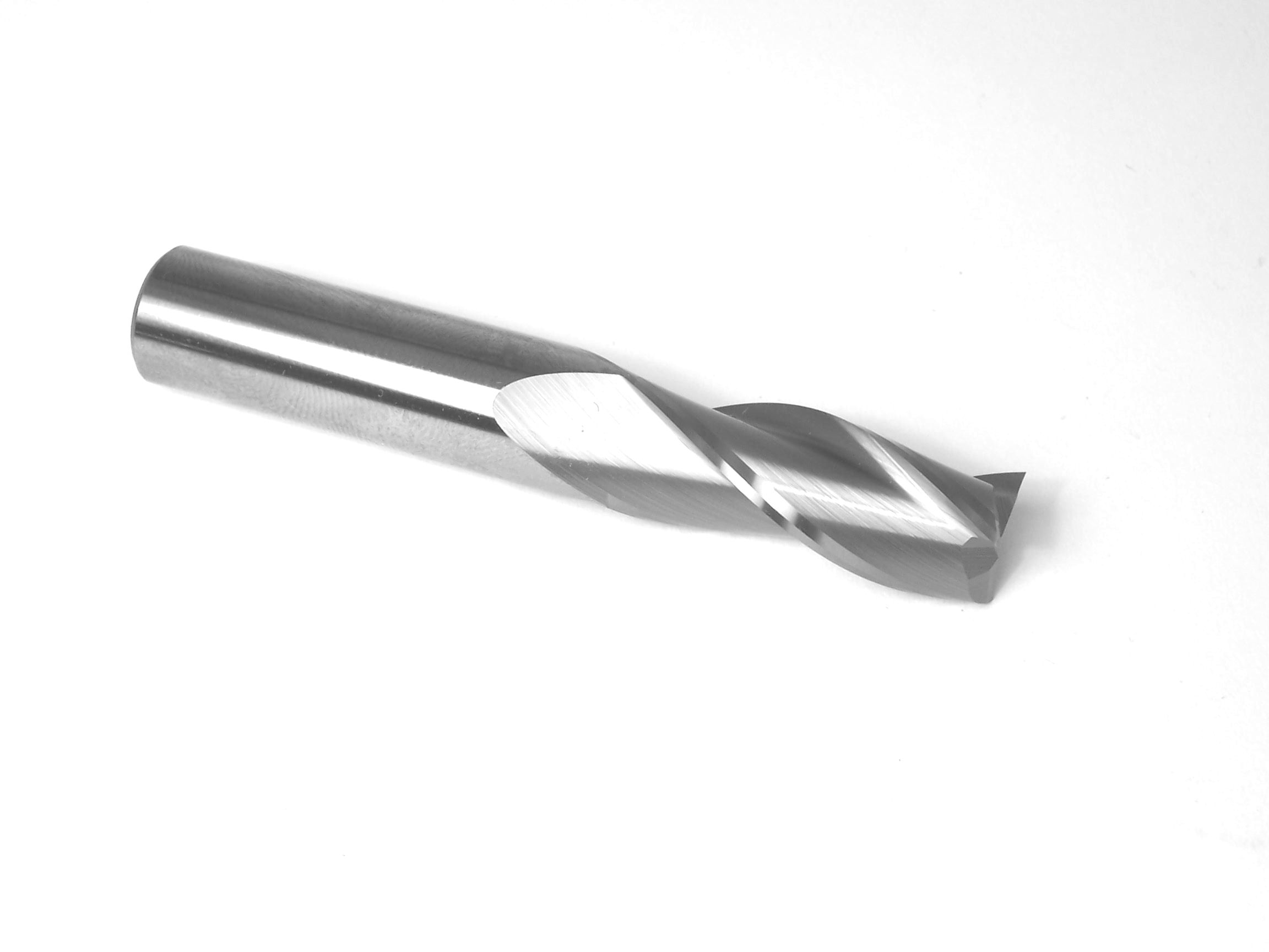

i own a 3 flut upcut 16 mm cnc bit
what rpm should i use for this kind of bit

I have a 40 hp pump so i can move fast. You prob have the spindle hp but not the vac hp to hold the parts. Id run that tool 16500RPM 1000-1200IPM all day.

Cutting length of the bit, Material thickness, and # of passes will play a big part in feed rate along with the RPM as well.
