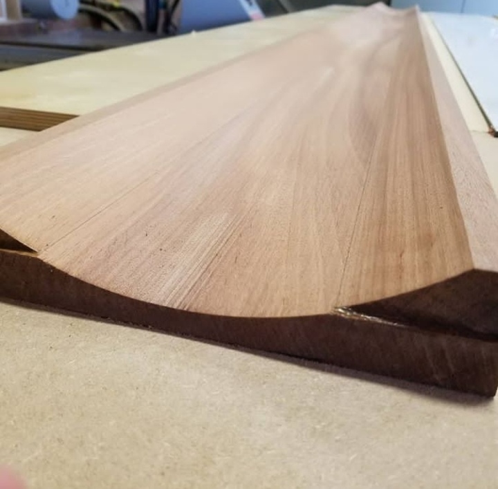

Alexi Member
Ah ok i understand
What about work like that
View higher quality, full size image (720 X 707)
1/18/19       #4: Tips of production ...
Scott
How big is the piece in the last picture, how wide and how long. It is not that difficult to run on a cnc, if it is not to long for your table, I would order tooling to match the radius on the piece, if it is a consistent radius. For Production depending on the size, a cnc is not the tool of choice in my mind, you need a moulding machine or a shaper. You may have to do multiple passes and no matter what you use you will have to get custom tooling made. A person would need to know the size to give you the best method for production.

That the problem i have multiple sizes in length and in width
My cnc can handle till 4 m thats no problem
In width i have 10 20 30 40 cm
Thicknesses about 8 cm
The shop where i buy my bits told me that a ball nose bit can give me this shapes
I will have to do 3d work?

The first pic is easy, just make sure you understand stepped cutting cause itís pretty deep/thin in middle cutout for hardwood. The second pic is not worth doing on cnc unless have too. Order that standard cove style crown from a supplier in any species you want, they are tooled up for it with moulders.

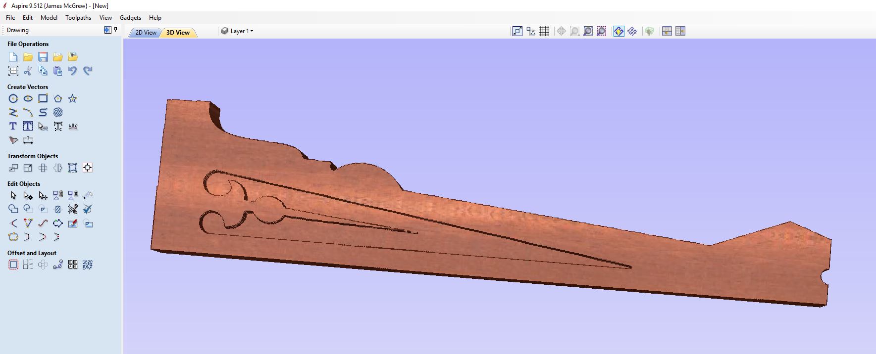

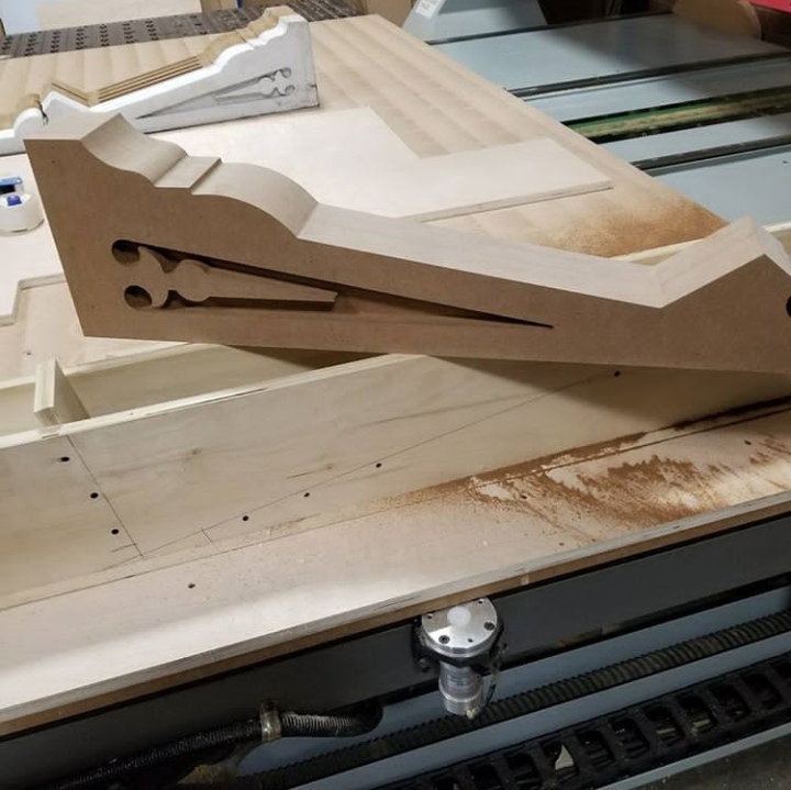

Yes you can use Aspire for all of this, Yest on Moulding it is far far less expensive to have it run if you need any large quantity.
If you need a few feet then it can be done with a large ballnose and a 3d path.
I did both of these files in less than 10 minutes, ready to cut the legs with say less than 6 min per leg
the mould is a 3d file and with a BIG 1-2" Ballnose may not take too long if you do not need 500 feet

We would machine both of these in Vcarve easily. 2D toolpaths for the bracketry and unlike James post (which is most definitely fine) we would use a molding toolpath for the cove molding.
We do a lot of small run reproduction molding on the CNC. Jobs where the customer needs 3' of a given profile, or 10' of a piece of base. Without a doubt there is a breakoff point where running the part on the molder is better. Thats easily calculated by the cost of custom knives, setup, and so on. For us, its usually about 30' depending on the profile. It simply doesnt pay to have a set of knives ground and the setup to run 30' of molding.
Using a 2 rail sweep in the the molding option in Vcarve you can run any of these profiles with simple ball nose or other form tools. There is a little handwork at the end for cleanup and if its a high dollar job grinding the knives is still the way to go but most often for a short run the CNC does fine.

V carve Pro has a lot of features added since it was my primary software (2008) I have used only Aspire since then, the corbel is a 2 d file, I did the molding with a 2 rail sweep.
