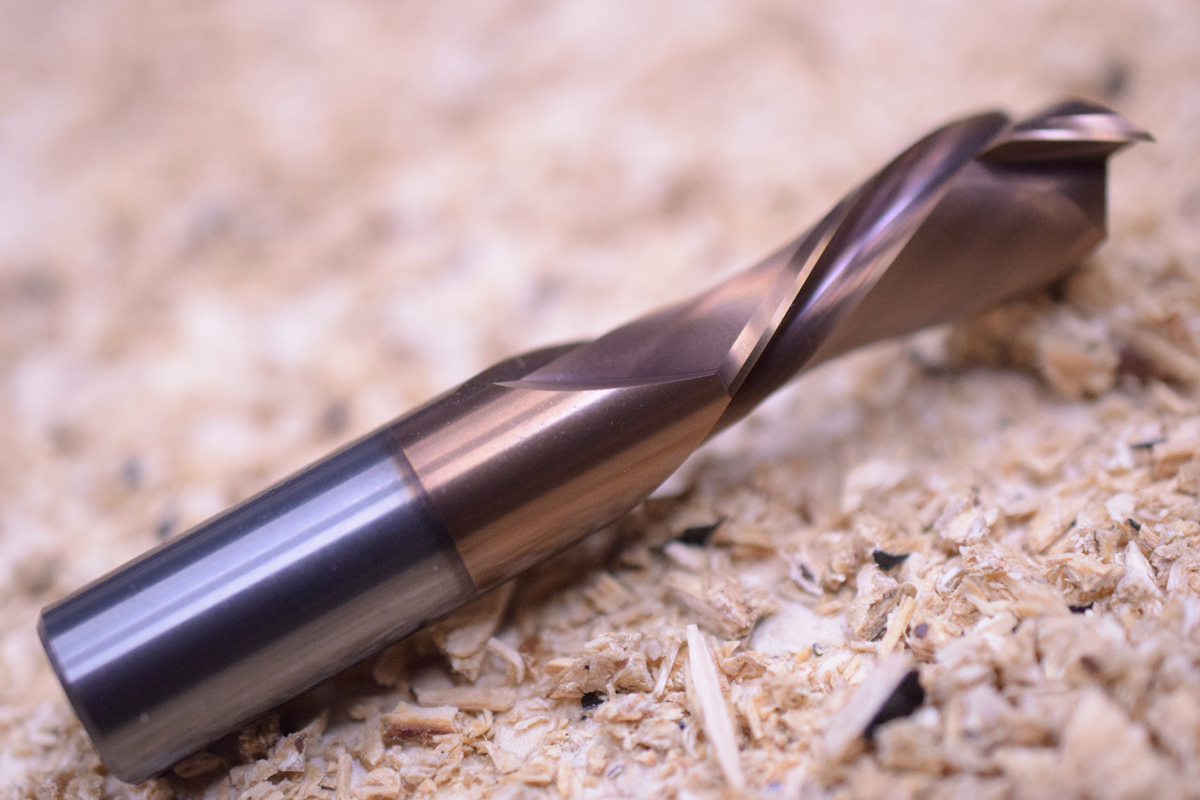

I would always recommend ramping in where possible. Also remember a PCD bit will usually not run as high of feed rate as a spiral just due to it usually being on a shear vs the spiral. But in the right application will out last the spiral hands down. I would try the new coated bits that most of us have out.
View higher quality, full size image (1200 X 800)

Chuck Hicks Member
Coated bits are easily getting 30 to 40% more life than standard bits, some are getting a lot higher in certain applications.

We tried PCD and it wasn't worth it. I suspect the corner chipping is due to the use of the PCD. How many flutes? We now use the coated (Marathon) Leuco 2 flute compression, Get much better life when cutting HPL laminated board than with the non-coated bits. On melamine we get about 25% more life out of the coated bits. Well worth their minor increase in price. We are picky about the quality of cut so we can get good banding results. Our old bander doesn't have pre-mill.

Chuck Hicks Member
Gerry,
Not completely, When we sharpen a coated bit, we only sharpen inside the flute, not on the Diameter, You do loose some benefit, but not all.
