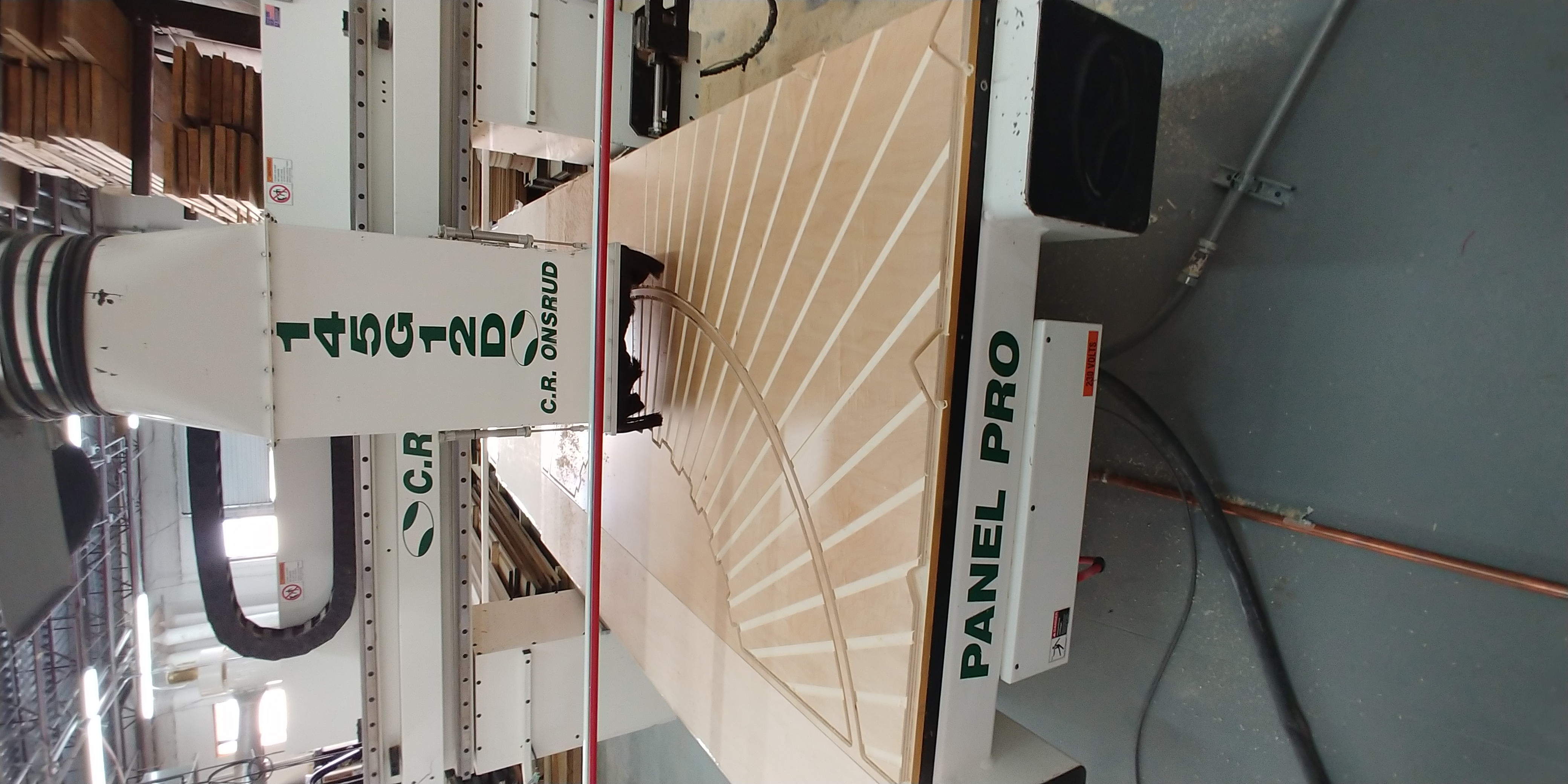

We have recently purchased a used 5x12 CR Onsrud CNC router and it does have this control. At first we found very little information on the control. It does work great however and we have been processing sheets since we got it going for about three months now. The machine is VERY well built and runs well. The control can be serviced both by Onsrud as well as some aftermarket companies we have found. When we bought ours it came with a pair of pendants so we have a backup. Lots of spare parts etc. We had some initial difficulty getting post processors made for it but now that we have it going its a pleasure to use. Cuts fast and straight and clean. Onsrud is helpful but they do have some rather high priced ideas about getting service setup. They wanted us to pay like $10k to setup an initial visit to go over the machine and install some parts before they would give us support. We decided to go another direction. The control is not that complex really and the parts are typical commercial CNC so it does not appear that we would have any trouble getting replacements for most of it from original manufacturers or other suppliers. I have built several CNC retrofits and run many CNC machines over the years so this one does not seem much different really. Your mileage can and probably will vary. ;)
