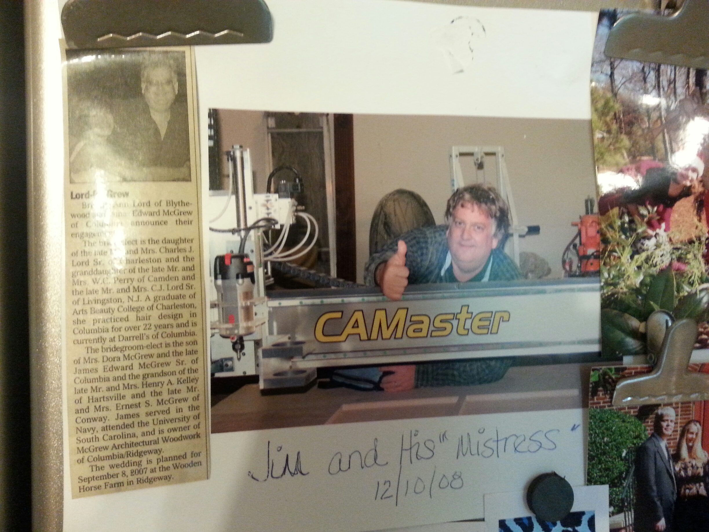

james e mcgrew  Member
Speaking of Wives ! I got married on Sept 9 2007 I bought my first CNC in November 2007, This photo has been on the refridgerator ever since
View higher quality, full size image (2448 X 1836)
