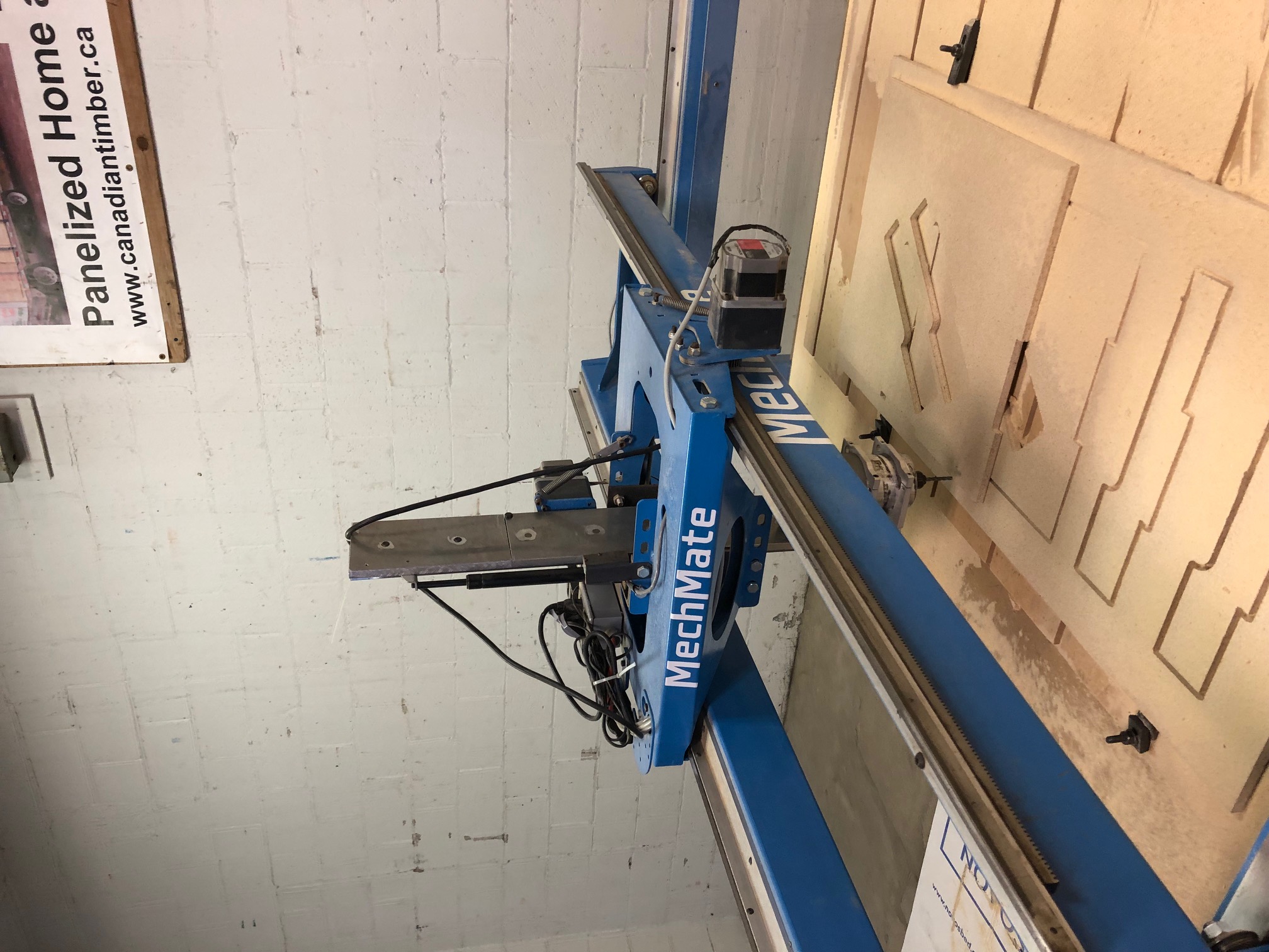

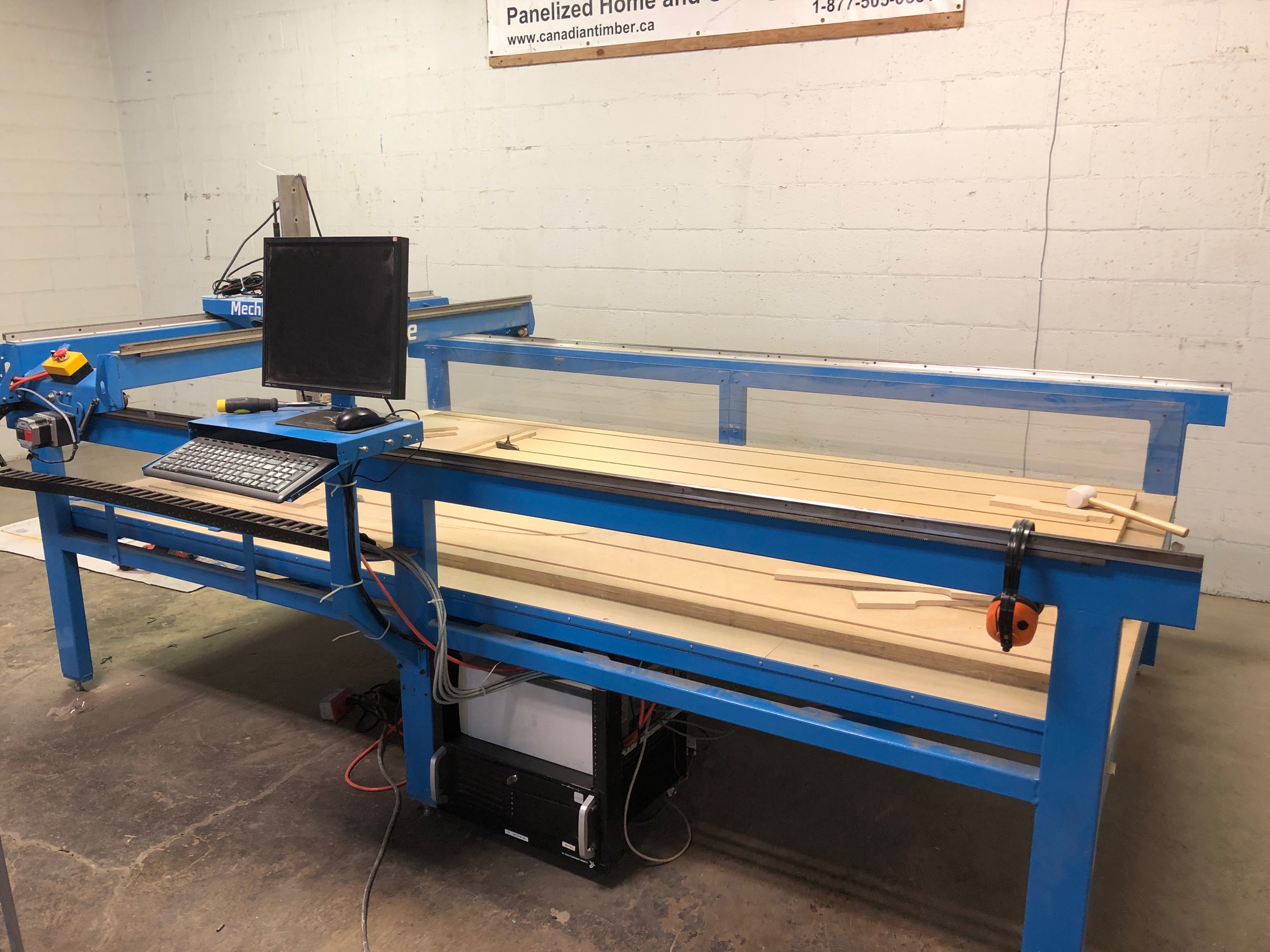

Chris DeVries
Thanks again for everyone's input. The machine is a 5x10 MechMate. I have attached a few pics. Even though sticking with a porter cable would be easiest I think I'm leaning towards a 2.2kw 3 hp spindle...unless that sounds crazy.
My understanding is that the hp on the spindle is a more continuous rating compared to the router.
