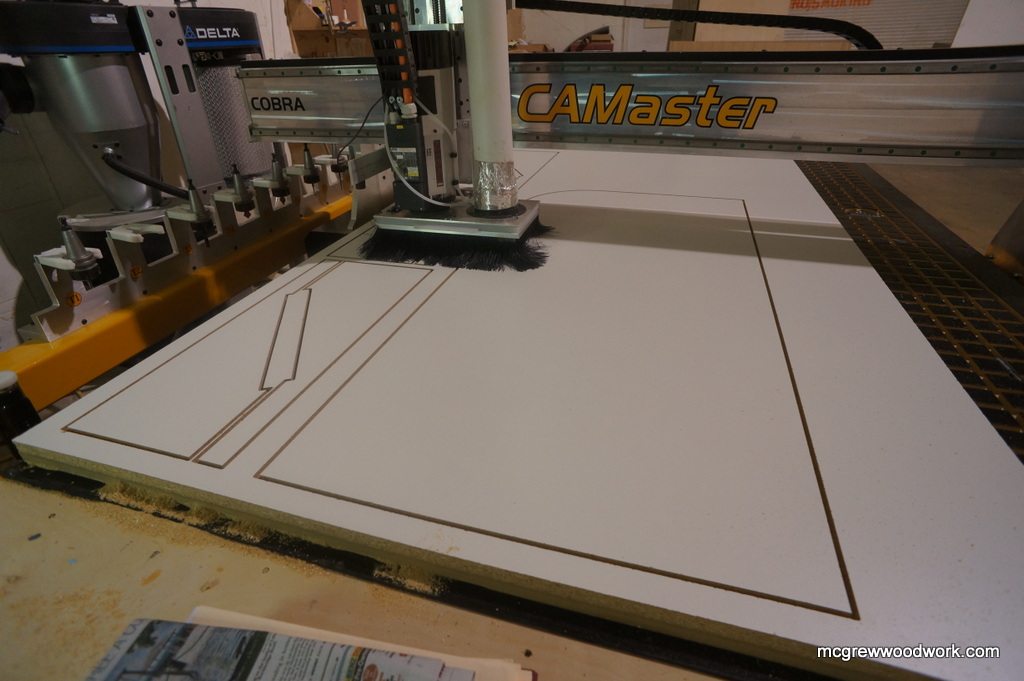

james e mcgrew  Member
a CAMaster will, Great machine and I would venture a better price with lifetime support.
forum is CAMheads.org website below
