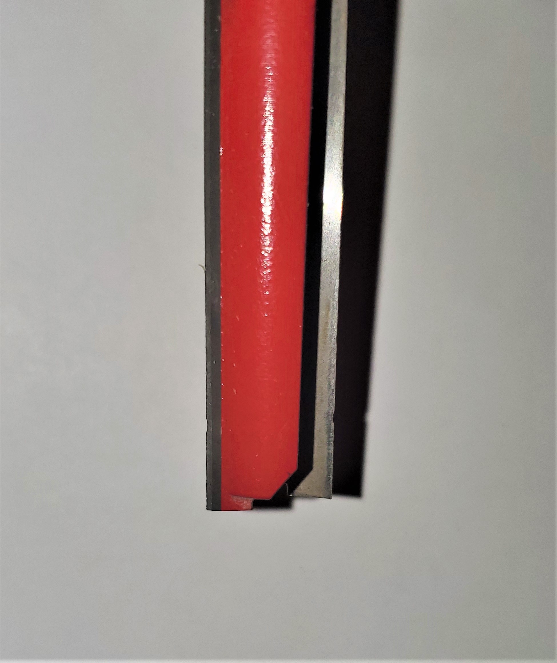

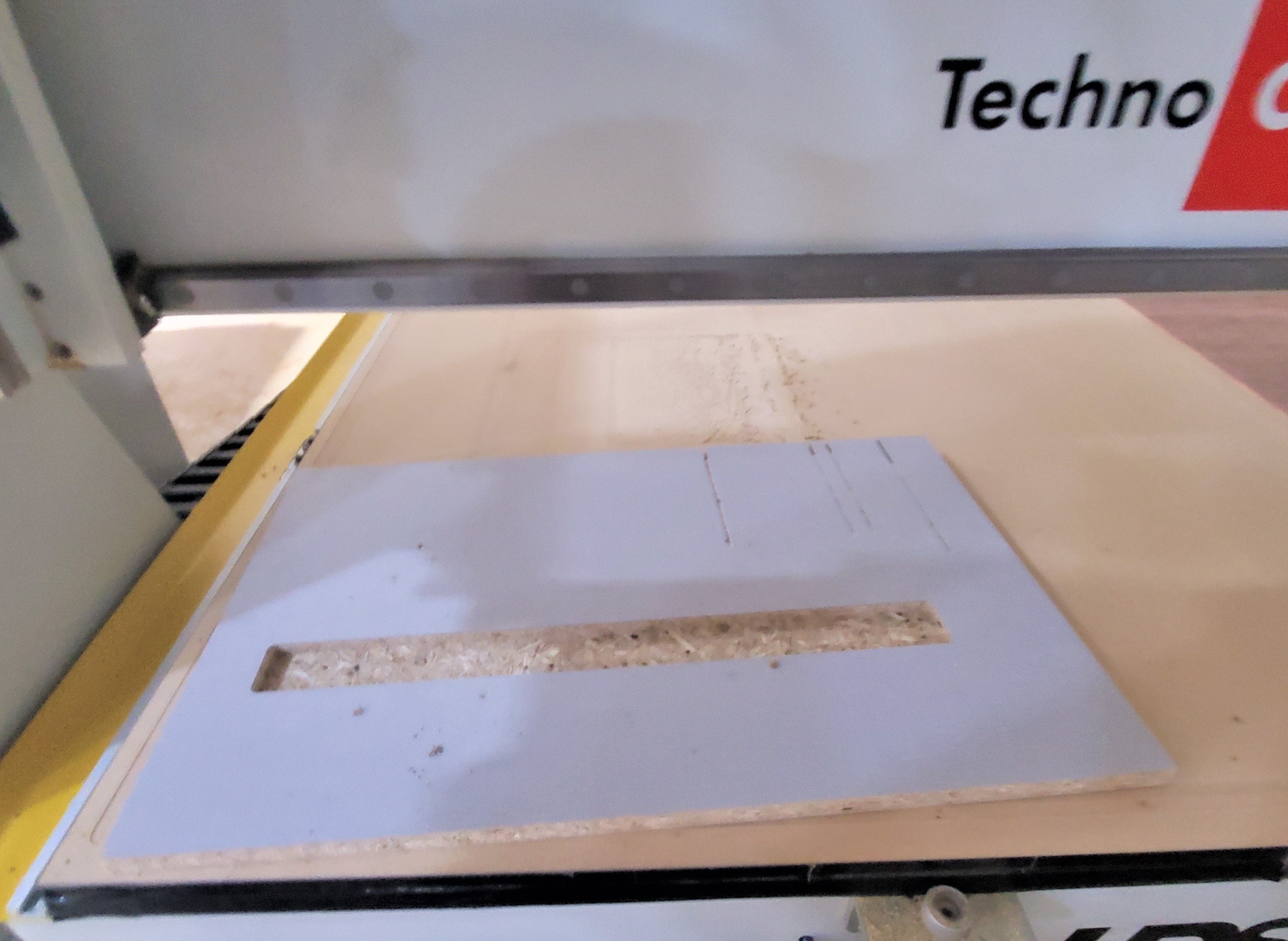

Just to give you an idea. I read a really nice post where someone suggested using a straight bit for HPL. I grabbed a scrap 29"x18" (74cmx49cm) and ran a test with a Freud 12-128. I did the profile and a 1/2" pocket. It shattered the edge at 1/2" exactly. Pictures below.

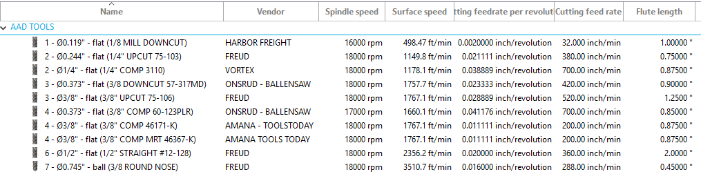

Here is a picture of all my bits feeds and speed and speeds.
On 3/8" bits, I do one pass plus onion skin. usually 0.015" (0.4mm) the onion skin.
1/4" bits on 2 pases and onion skin. But 3/8" are my go to.
I will definitely try that technique the 0.02" finish pass and slower RPM. I feel maybe lowering RPM to the 16K range might reduce wear and impact on bits.

Is that straight 2 flute bit ground for plunge cutting? Most aren't.

And for the pocket I did a very shallow angle ramp. 2 degrees. The straight bit seem to be able to handle that pocket path well. Apart from getting shattered hahaha. Nevertheless I don't think I'll be using more straight bits.
Thanks for the advice.

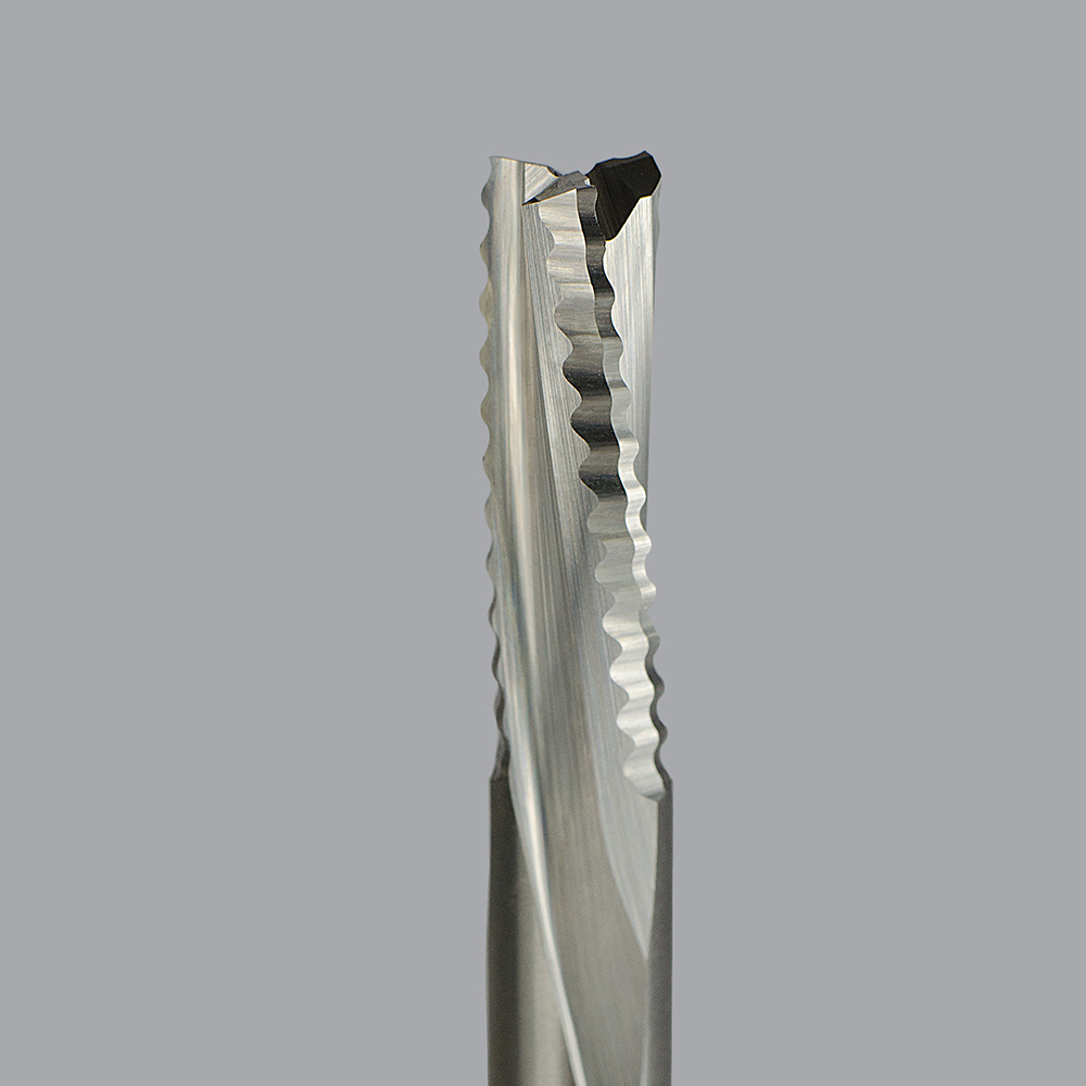

Also, I'm using a roughing pass with a down cut Onsrud 57-300 bit that takes most of the punishment and leaves 0.03 on the sides and a onion skin to be cut by the compression bit Vortex 3130xp.
I ordered 3 flute bits now as myprodiction time got significantly slower. But with the faster speeds of 3 fluted bits I might brake even.

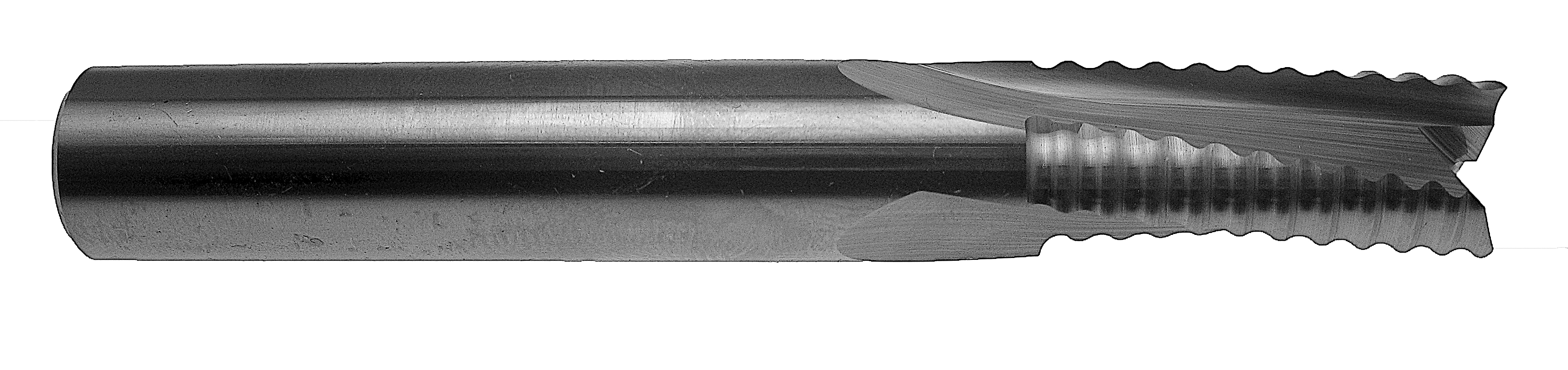

One question if anyone read this, whats the firence between low helix and regular helix. I ordered regular, but was wondering about any potential benefit. For example something like a Onsrud 60-038 Hogger.

Chuck Hicks Member
Alex,
I cannot speak on the other companies bits, but on ours, the low helix or slow spiral is about half of the regular helix. This is great where HP maybe an issue or lifting of the part being cut is an issue. Hope this helps,
