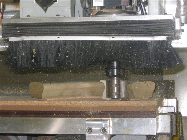

Could anybody tell me who make or sell the moulder like head that fit into a iso 3o toolheader like picture. Thank

Google ISO 30 1 1/4" arbor and you will land on a bunch of arbors you can mount a corrugated head on. Depending on your spindle it may be a lot to ask of your machine.
Cant tell for sure but that moulder head looks like it might have a 3/4" shank into a collet which wouldnt make me too comfortable. Cant find the source but I had seen a small aluminum moulder head with a 3/4" shank or arbor. Would make me pretty nervous having a handrail knife with that kind of projection hanging out of a BT30 collet.

Thats my machine. We have two of them. Can also be had in CCW version.
http://cggschmidt.net/flipcatalog/mobile/index.html#p=44
9/10/19       #4: Who make of sell the moulding head ...
BTW, HSK63F holder. Tool has 3/4" Shank. Keep the RPMs low, 6-8k if your spindle has any horsepower down that low.

Mark B Member
Thats the holder I was thinking of. I'd never have the HP that low (10HP spindle). But agree, if your spindle is up to it have at it.

Yes, my spindle is up to it. Down that low, I'm still in the neighborhood of 10h.p. based on the power curve from the manufacturer. Either way, it cuts well.
