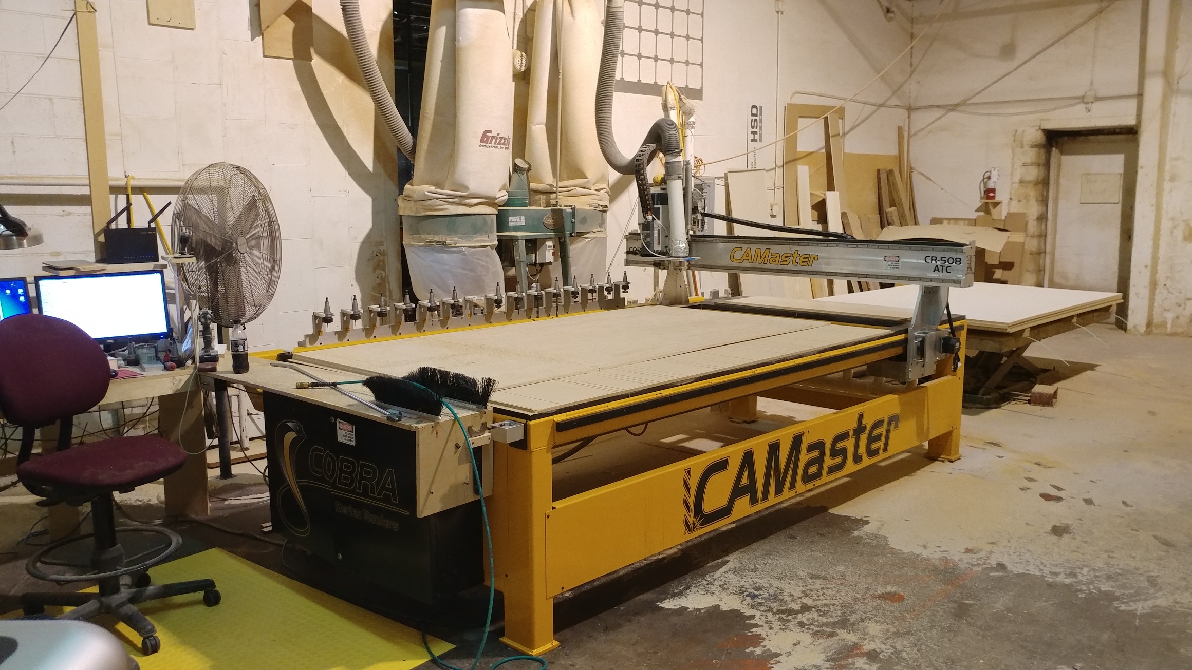

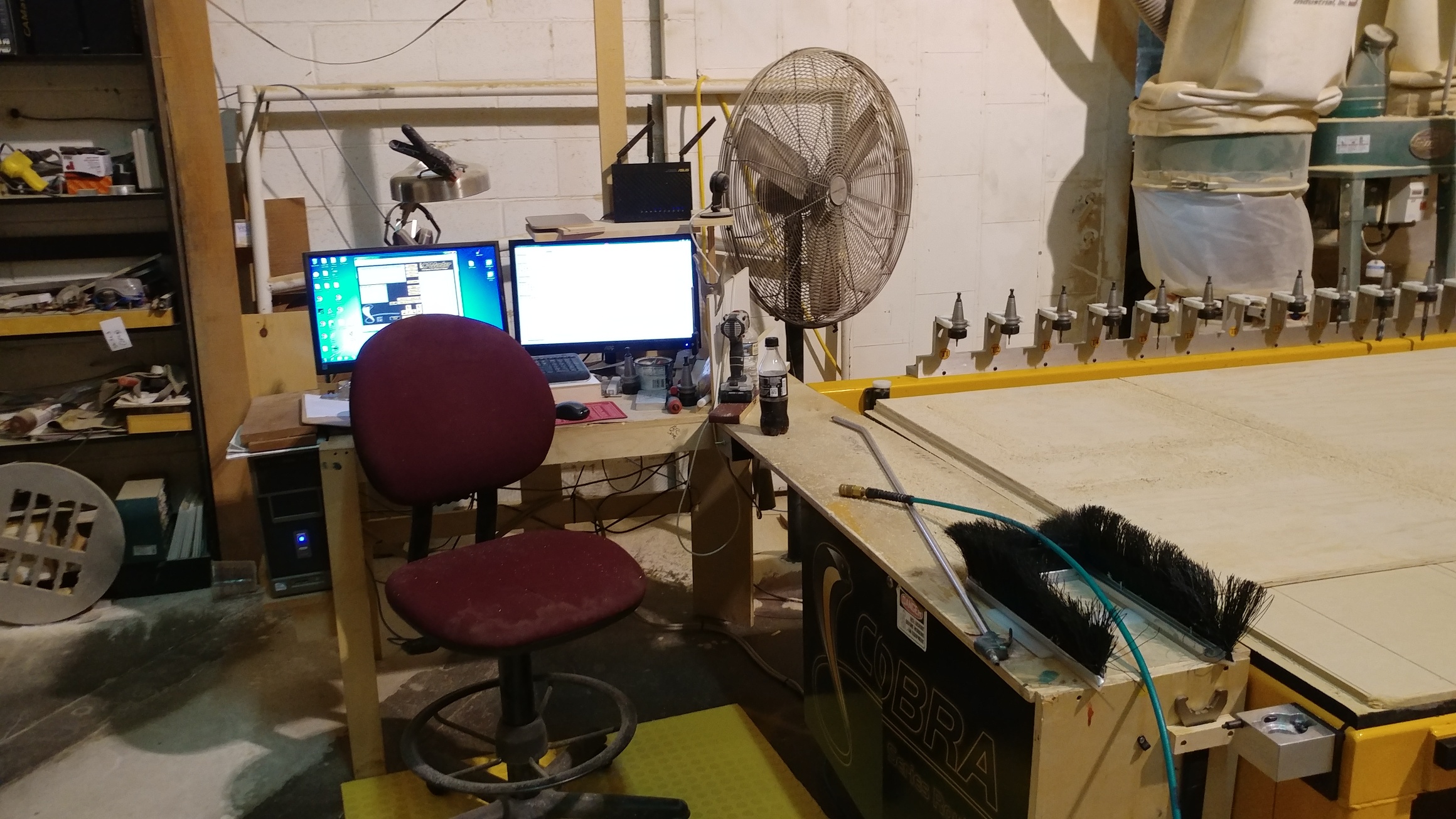

I was in the same need in 2007 and looked at those same machines,, I went with CAMaster for many reasons, I would definately place them in your list, Go see machines, visit the plants where they are built. you are gonna need those guys and you need to have that relationship.
last week my power supply on my 2012 model cobra was giving me a fit, one call and i had a new one the next day.
take a look at the site and then check out the forum below, feel free to join and ask questions,, it is a CAMaster support forum with a few thousand other guys just like Us trying to make our way better in our chosen way.
