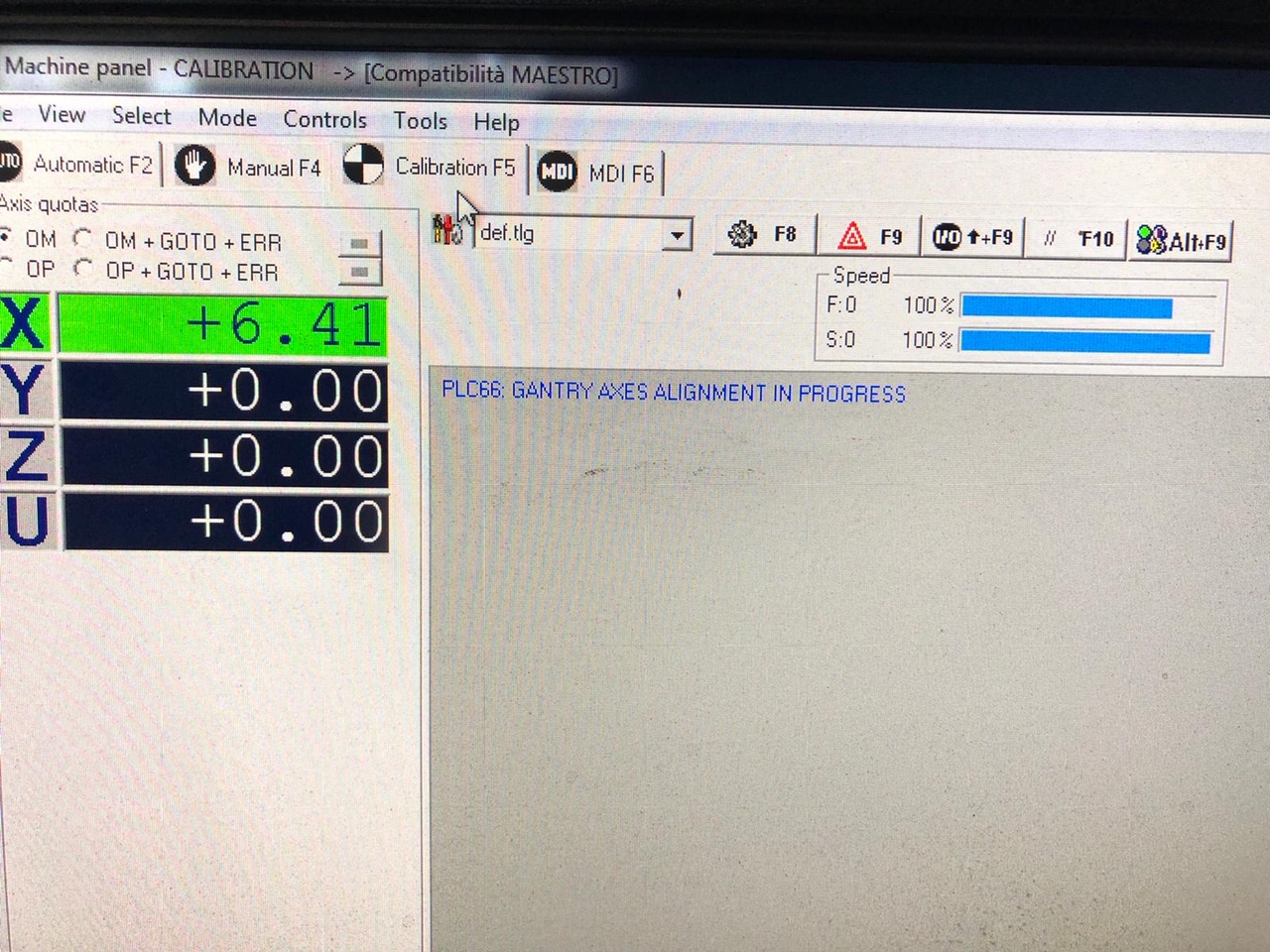

I have an SCM Pratix S22-31C. All was running well until yesterday i get error - PLC66 Gantry Axes Alignment in Progress.
This appears after calibration and seems to be an issue with Axis X calibrated to Zero but Axis U is +6.48. with the axis not being within 0.7 of each other the machine will not oeprate.
Has anyone got any possible solutions, Manual says to contact SCM, but wont be able to until monday morning and have some pieces that need cutting.

12/3/19       #2: SCM Pratix S22-31c ...
Reboot
Check all limit switches.
Reboot
Might help.
12/3/19       #3: SCM Pratix S22-31c ...
Nik Member
I have this same machine and had this problem about 2 years ago...My technician had to come and fix it...I can't remember what he did but I do remember it look him a couple of minutes..(nothing serious). Good luck
