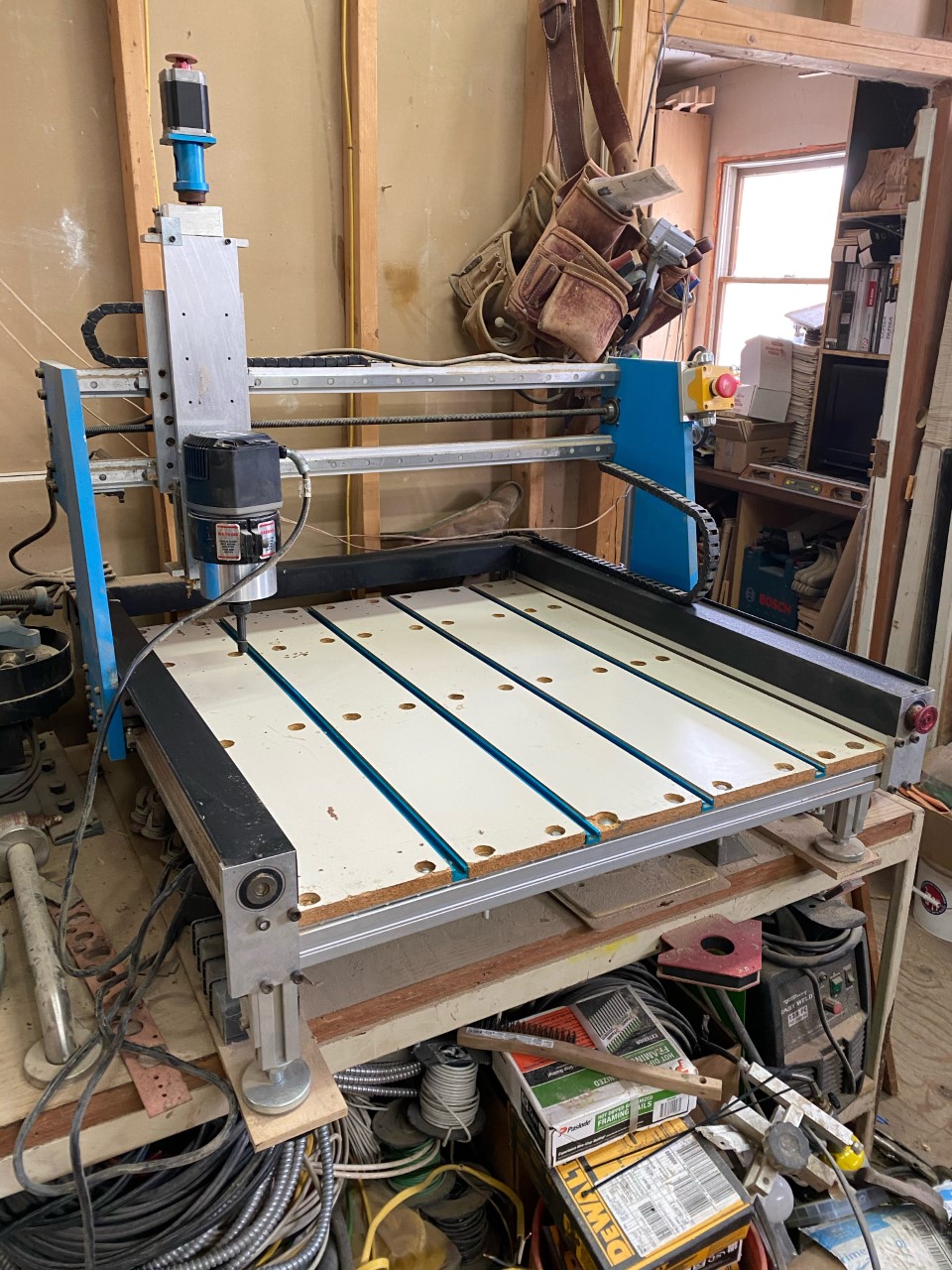

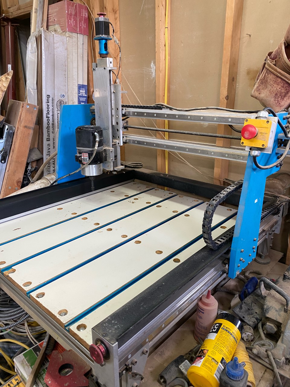

Hi Guys,
New to CNC's. Picked up the pictured CNC at auction very reasonably. Hoping someone Could identify manufacturer. Also, need opinions on a new controller & software.
1/22/20       #2: Software & controller ...
Looks like something from Rockler.
1/23/20       #3: Software & controller ...
Ian
Bulidbotics has a nice controller, USA support too
http://https://buildbotics.com/
1/23/20       #4: Software & controller ...
Ian
if you only plan on doing flat stock, vcarve should work well
1/24/20       #5: Software & controller ...
BH Davis  Member
Talk to these folks. They can guide you through a do it yourself or plug and play system.
They will recommend either Mach3, Mach4 or UCCNC for the control software. Both systems are inexpensive and full capability options.
CNC4PC
1/25/20       #6: Software & controller ...
jerry Member
I would look at Centroid Acorn contoller and Vectric Vcarve
1/25/20       #7: Software & controller ...
BH Davis  Member
Jerry,
I'd never seen the Acorn Centroid controller. That looks very promising. I kind of wish I stumbled on that before I began building my new control with the UCCNC setup. I certainly would have considered it as a much less expensive option.
1/25/20       #8: Software & controller ...
Ian
why not run GRBL?
