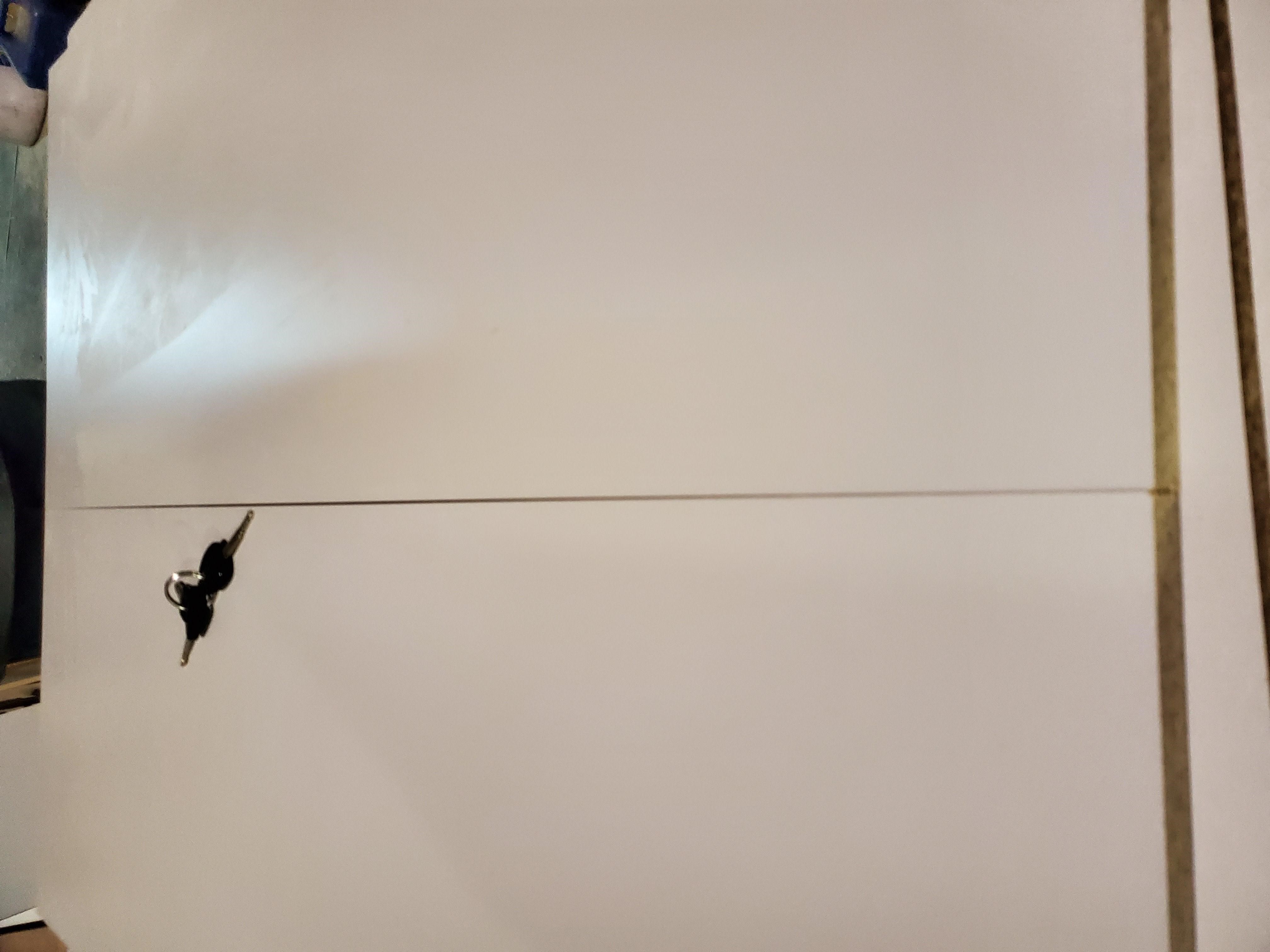

Here are some destructive testing results for posterity. I routed 2 rectangles 24 x 96 out of a 49 x 97 sheet, burning 1/8 off the factory edges. After a thorough cleaning and pushing the parts together, the rangerboard touched at the outside corners and left a .060 gap in the middle. Flipping both parts and pushing the previously outside edges together, they contacted in the middle and left a gap at both corners. I now have 2 bananas.
I ran the same test with a leftover sheet of Weyerhauser MDF, formerly Plum Creek, and got 2 proper rectangles, with no measurable gaps. This appears to be a cut and dried demonstration that 1) my machine is healthy, and 2) CNCs can make bad parts if the material is under stress. Dropout, I'll be using your strategy to oversize parts by a bit for the first pass from here on out.
