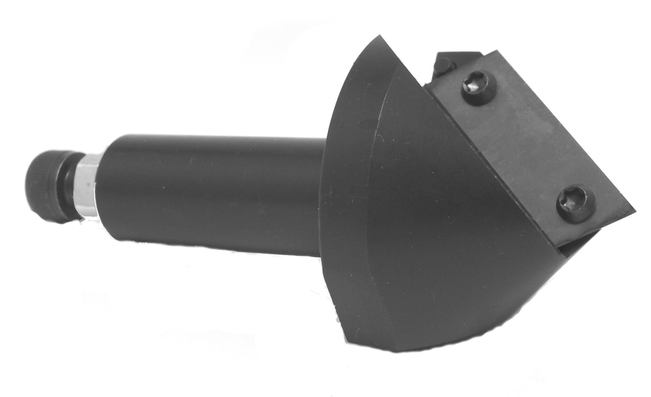

Insert V Groove Bit is the way to go
View higher quality, full size image (2110 X 1288)
