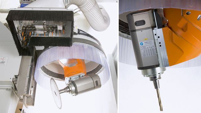

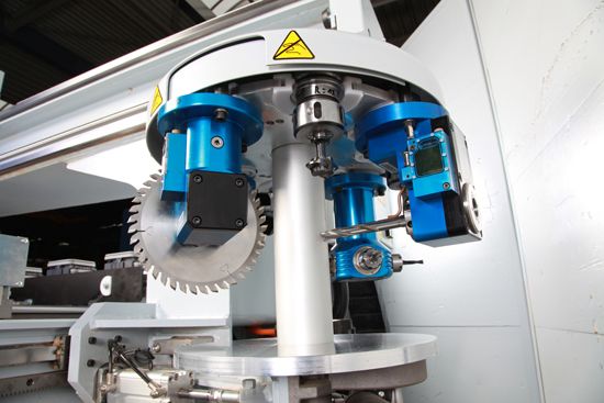

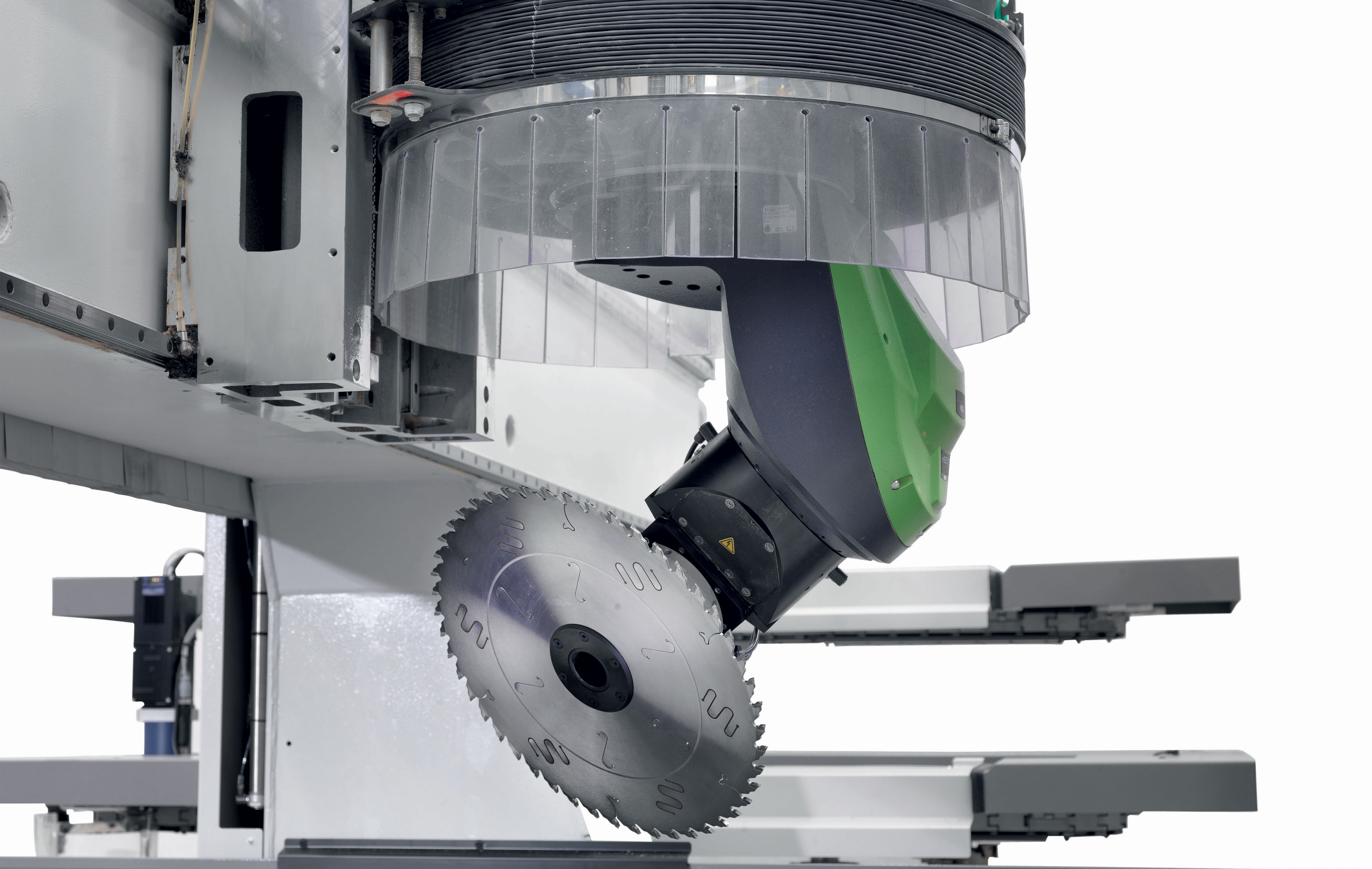

These are some C axis and some modern 5 axis setups. Like BH Davis points out, in woodworking C axis rotates on the bottom of a vertically mounted spindle. In metalworking it can have more varied orientations.
View higher quality, full size image (550 X 367)
View higher quality, full size image (4724 X 2991)
View higher quality, full size image (640 X 360)
