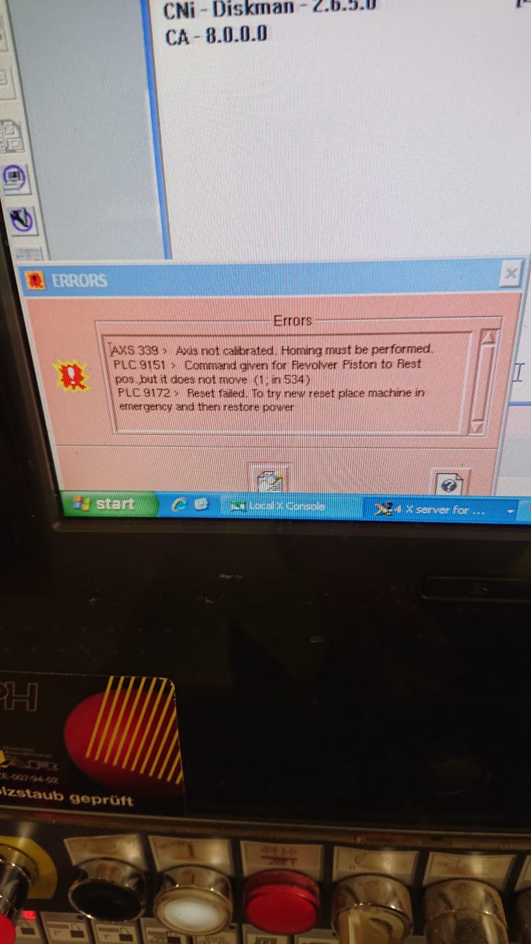

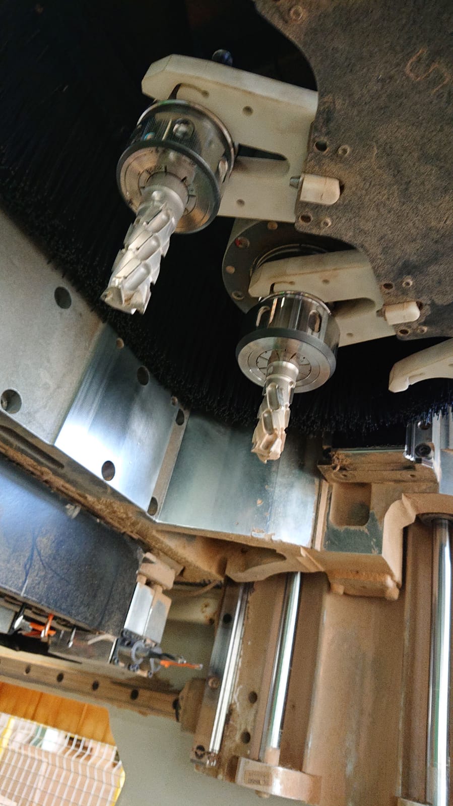

Wondering if anyone can help I’m using biesse rover b4 My Router carriage is stuck on tool holder and won’t release It self and go back to into position

Not sure if you can do this at the control but I think you want to manually unlock the tool and then jog the Z axis up.
If you can't do it by the control, you should be able to unhook the airlines to the spindle, use an external line to unlock the tool and then manually push the Z up. You may have to remove or trick the Z axis brake if it has one. With the machine off you can then push the X and Y axis to a better place and home the machine.

Thanks for your help and advice I was able to decrease the air pressure and move the carriage out the way and then I manually took the tool out of tool holder and everything seems good again thanks

Either the control did not see the sensor that advances the carousel underneath the electro spindle ( best case scenario ) or one or more of the several sensors inside the router itself may have came out of adjustment. In the case of the carousel forward scenario it can often be a case of "when" the control sees the sensor go hot. Hope this helps!
