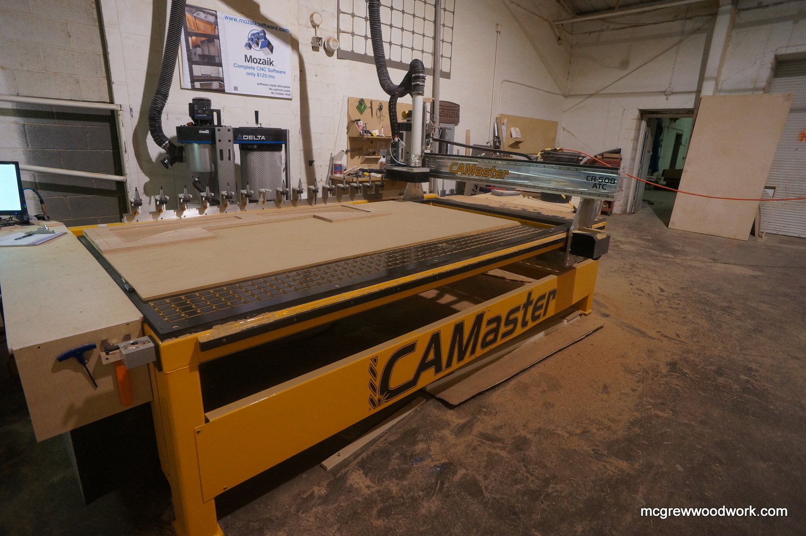

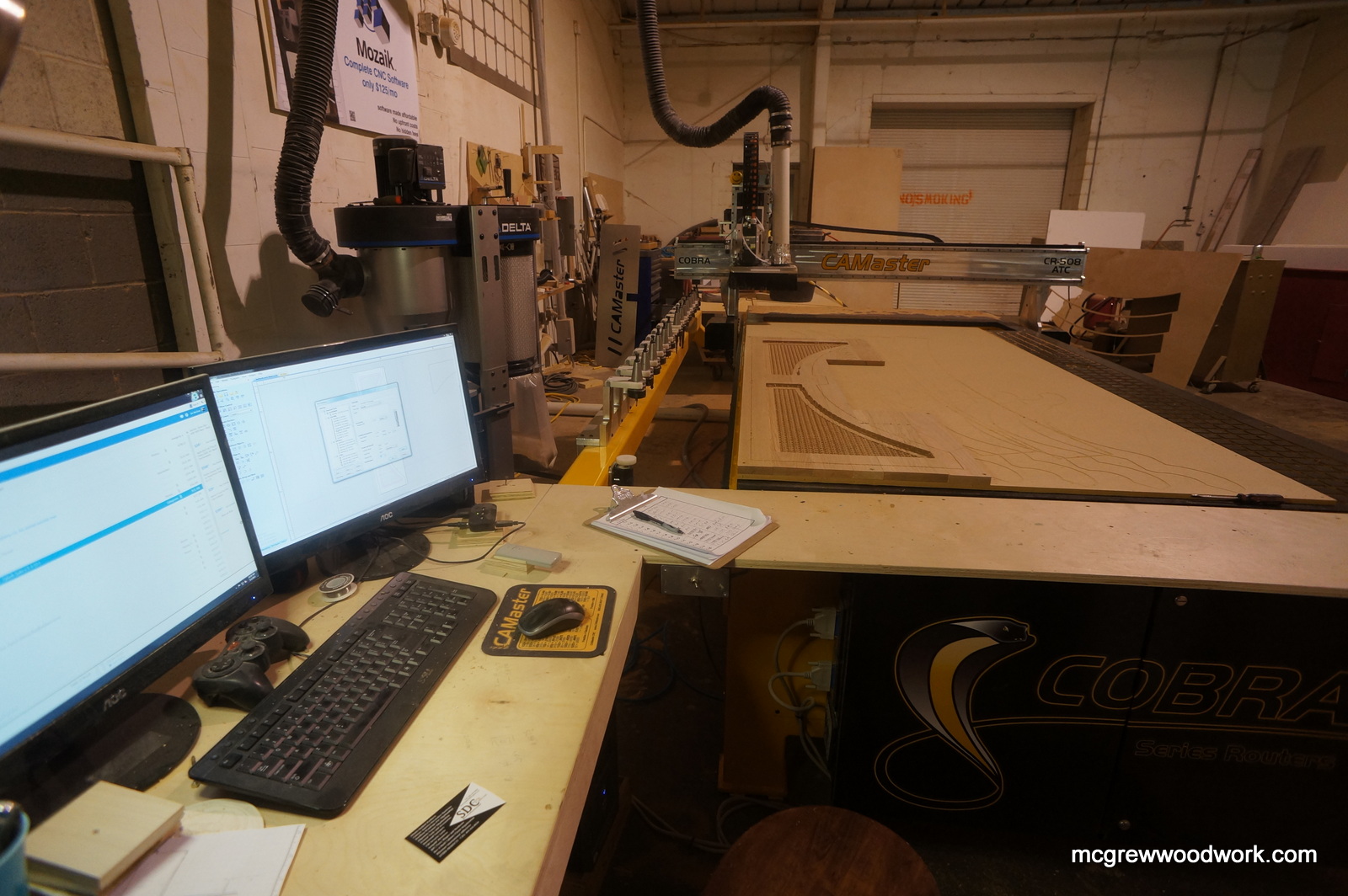

There is little to think "Laughable" about a mid size CNC with a ATC. mine is a 2012 Camaster with 25hp vacuum and dedicated dust collector. at this point our volume is higher thasn the one you listed and we pretty much were at the point you are in 2007.
we have used most all softwares (except) MV since 1997. When I buy a tool I learnedto by My 2nd need first and this meant i had bought the tool to last for a decade +
With your volume you will have cut Box parts machined and ready to assemble in 3-5 hours

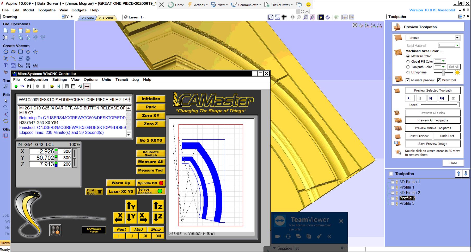

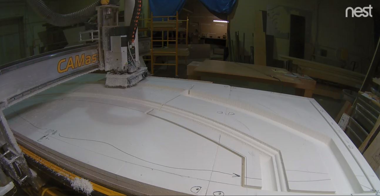

"Other Opportunitys" Plenty of that with a little application and yes with Vectric Vcarve and Aspire (other than Moziak)
I I ran this file 30 miles away from the cnc while working at my Farm. Just had a fellow go and clean up while the CNC ran
This is a mould cut as a negative in PVC A self build Homeowner is making his own Concrete Columns and arches for the entrances to his home
This is the main door arch over and I will show more later
